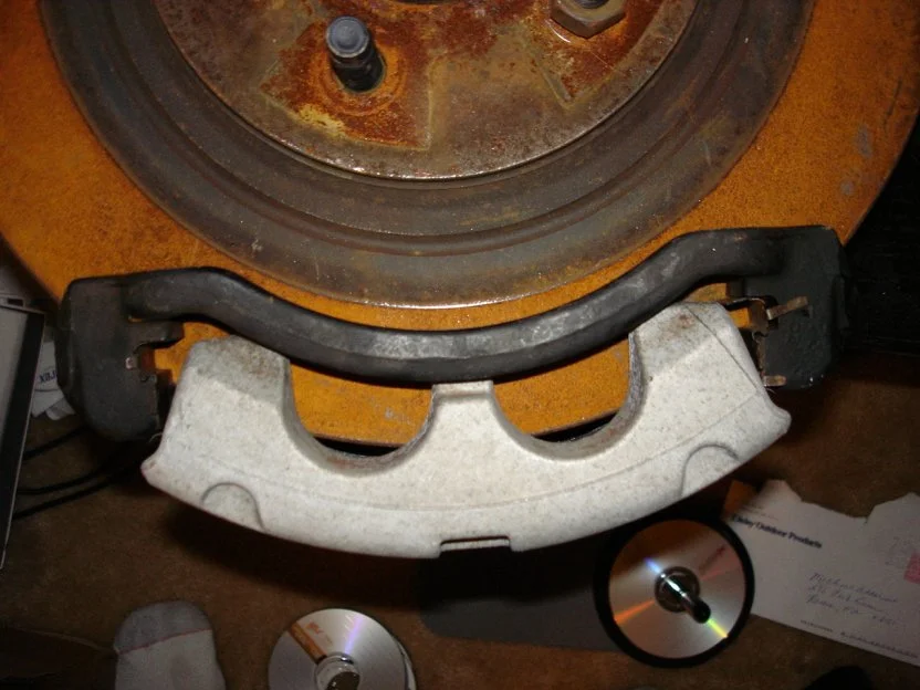

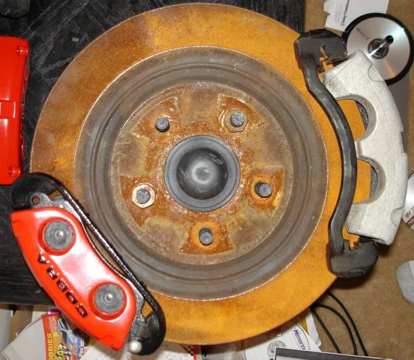

You can't run a 13" rotor with the stock GT calipers because I think that they are thicker than the stock rotors. I could be wrong on this though.
Not to mention the curvature of the caliper is totally different. You need to use Cobra calipers with the 13" rotor. As you can see, the GT caliper wouldn't cover the entire rotor.
