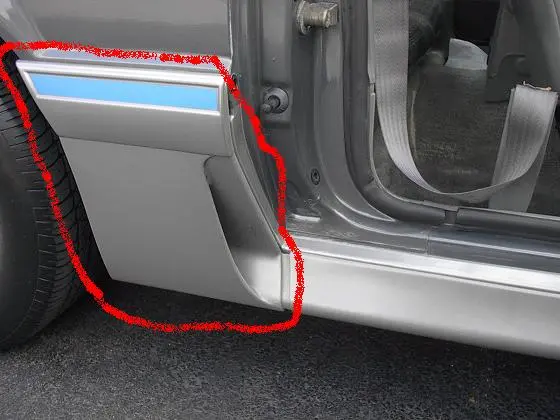

Does anyone know how you remove the ground effect off a mustang gt thats behind the door? Weve been trying for a while now but were afraid to pry it off and break it, does anyone know how it comes off. I have a picture of the piece that im talking about. Thanks in advance!

Follow along the edge of the piece and remove all of the screws.. You should then be able to slide it up off of the metal attaching bracket that's behind it.

2 screws in the wheel well and under the ground effect and it will slide off the metal bracket. just removed all mine i'm changing over to the LX

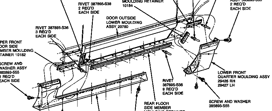

Maybe this will help:
