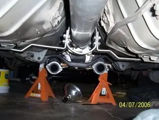

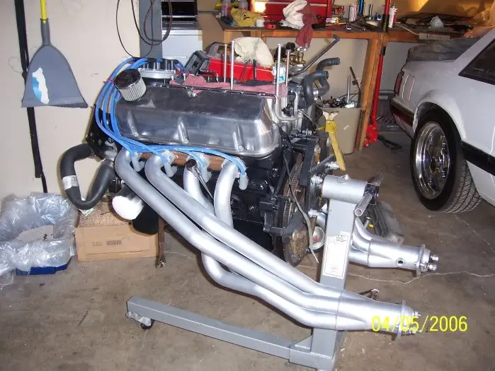

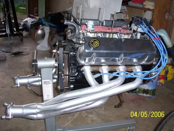

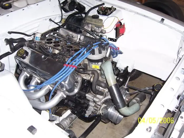

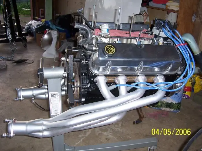

I have these heads with mac L/T's and have no issue's with plug replacement or wire issues. I dont go threw emisions so i dont know about that? I've also noticed with the crane (cobra) 1.7's or maybe with these heads alone i hear rocker tapping, i've set and rechecked the tourque and there right on! Here is a pic of mine on the stand i used the ford blue 9MM wires from summit! The L/T's do hang low but i mostly hit the mid pipe on speed bumps and other stuff but not bad as long as you remember your notdriving a 4x4! My car is even lowered!
Heres a pic from under the car :
peace
john:p

Hey "SMOKEDYA" those are nice pics, those give me a better idea about the access to the plugs with the headers on. It looks really tight but shouldn't be that hard. Unfortunatelly mine is a daily driver car and those headers won't pass smog check (I think) but the clearance should given with the shorty headers shoul be close to the long ones (I'm assuming)
