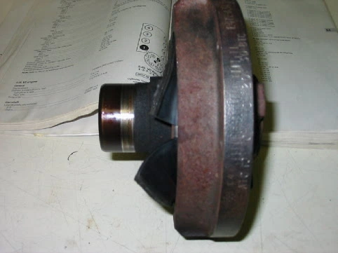

Heres a bad unit for ya....that rubber sticking out is a bad sign...yours is sliding back and forth on the rubber ring, I believe thats the first i hear of that.......
Can you say PROJECTILE....Damn..I wouldn't even wanna be around when it launches off that inner ring...
