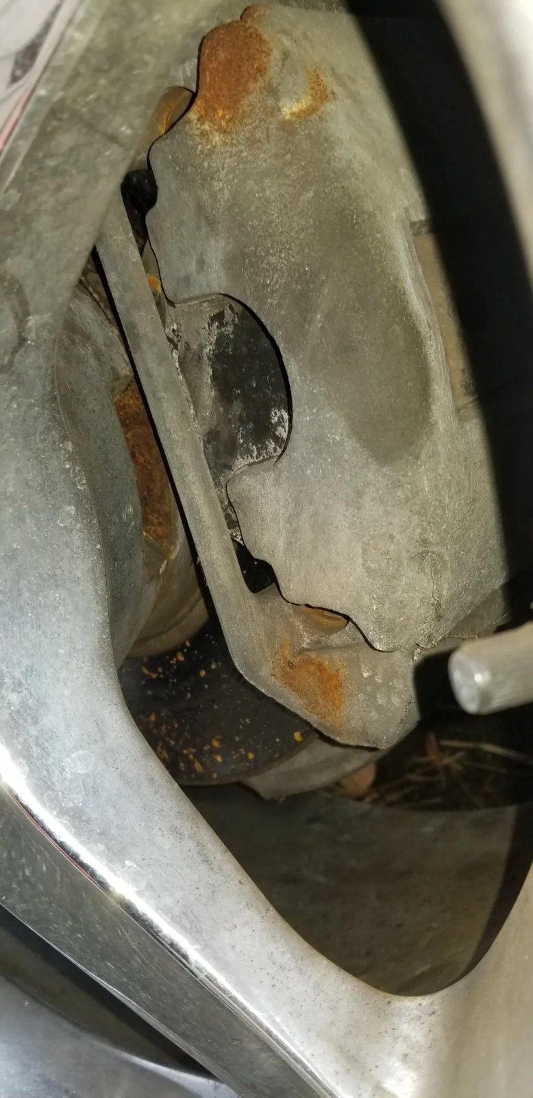

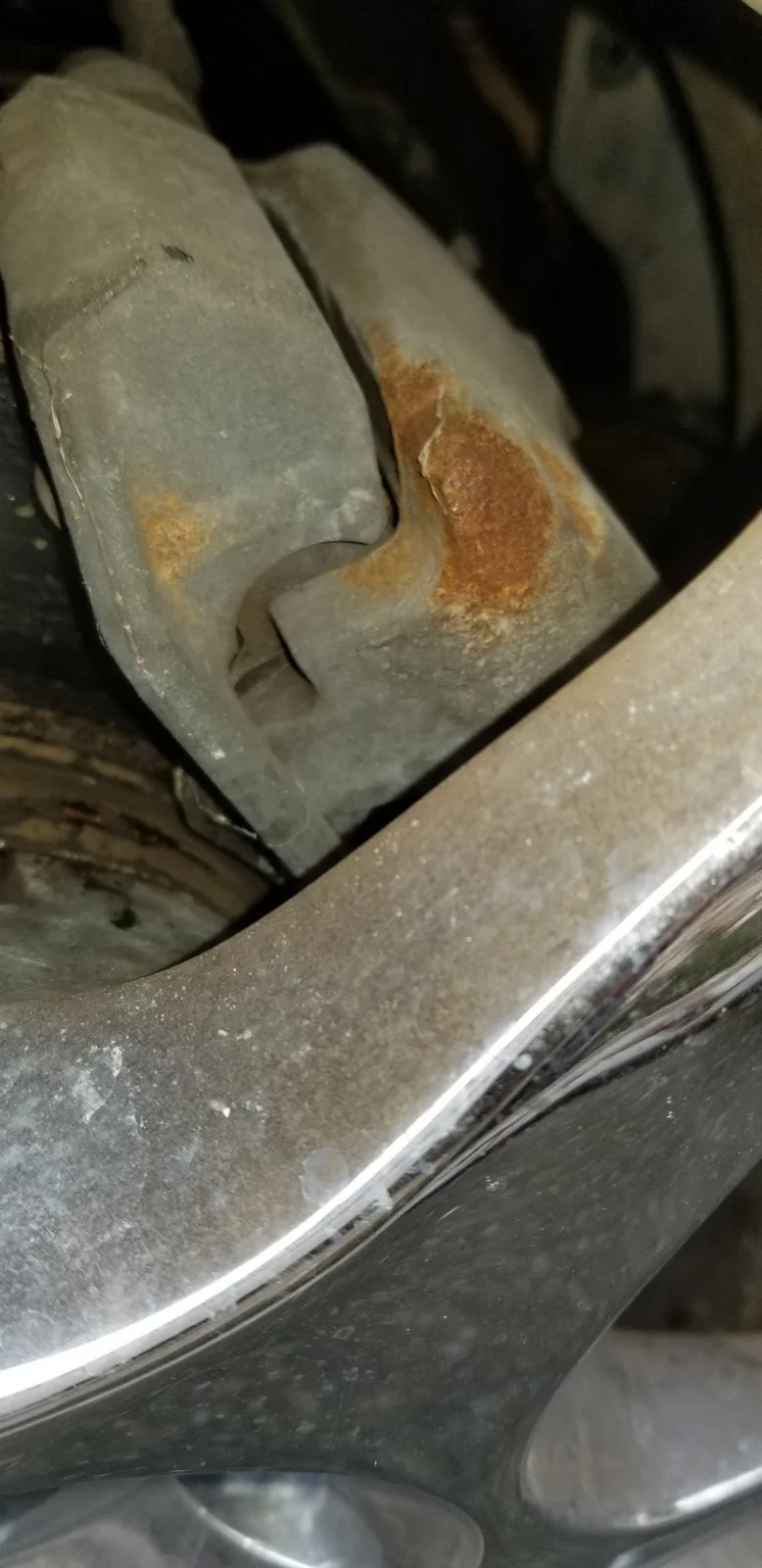

Please help I have an 89 mustang 5.o 5 lug I think the front brakes are from a newer mustang but 1 guy said the rears look like there off Lincoln and I need replace brakes and rotors and want to try to narrow it down to save some trips to store. Pictures are the rears are the ones covered in rust the other picture is of the fronts

If I wanted them to be the same what would be the easiest to do? Is there some calipers that would mount the same? Thank you for all the help
Ditch the rear setup and install 94-98 rear sn95 disk brakes.
It will require pulling the axle shafts out and installing new brackets. You can probably reuse your axles but you’ll need to pull them out and physically measure them
