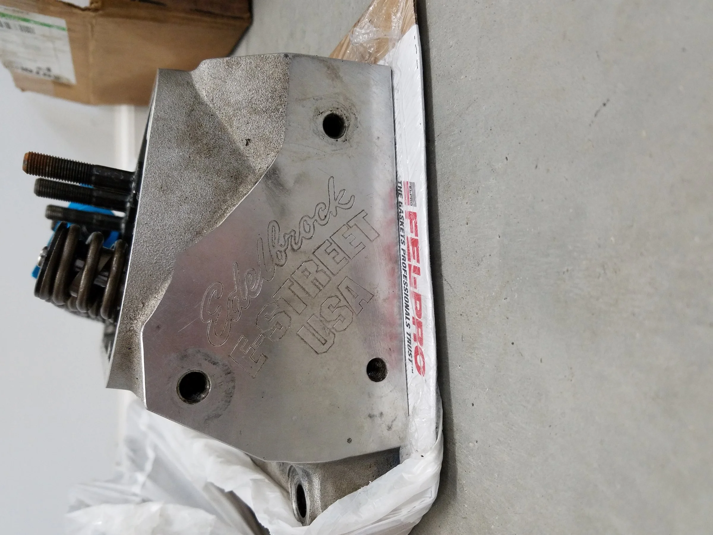

I just bought the 5023 E-Street Eddy heads. Used because I'm on a budget. Everyone I've talked to says to redo the entire valve train because they cheapened out on that part to be comparable in price to the cheap Chinese knockoffs. Anyone think that is true?
A) I would have started a new thread
B) ALWAYS have a shop look over used hardware. Let them know what cam you have so they can replace valve springs of necessary.
