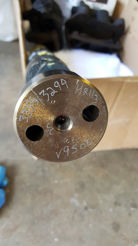

Can anyone tell me what this cam is? It came in an engine I bought and the guy I got it from wasn't sure what it was. Any help is appreciated. Thanks
The 3355 and 3299 are lobe numbers. I'm guessing 113 is the Lobe Separation Angle. I agree, it may be a custom from Comp. You can search the Lobe numbers in the Lobe master catalog and find most of the info.
