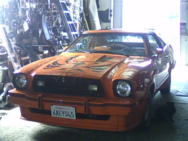

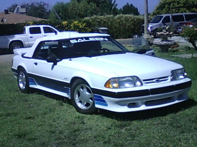

I have a Fox, is a 1989 Saleen conv. I never drive it, so it's gotta go also, so anyone out there want a 89 Saleen with 12,950 orig. miles, is #0085, never even been polished, is completely like when it was delivered to Oakdale Ca. with 4 mi. on odometer. I have every orig paper, w/sticker, shipp. paper, etc. Interior and top still near as delivered, A Saleen with 5 speed isn't a good kind of car for a 81 year old man. I also have 14 other mustangs, all early, 64 to 70 and two are 78's, one is King Cobra with 5,426 orig. miles, all must now go. Keep up the good work guys, I love to hear all the suggestions, etc.

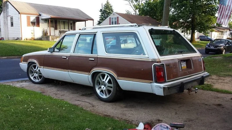

I bought in to the long rod 351 thing. So I have acquired all the parts to build one. Supposedly higher compression ratio on regular unleaded and smooth idle with good power. If it's a bunch of malarky I am gonna find out. The plan is efi with a speed density roller cam. If I ever get it done I will surely report my findings. There is a bit of machine work necessary. I should mention that displacement remains the same. This is for the daddywagon which will be a 100% street car.

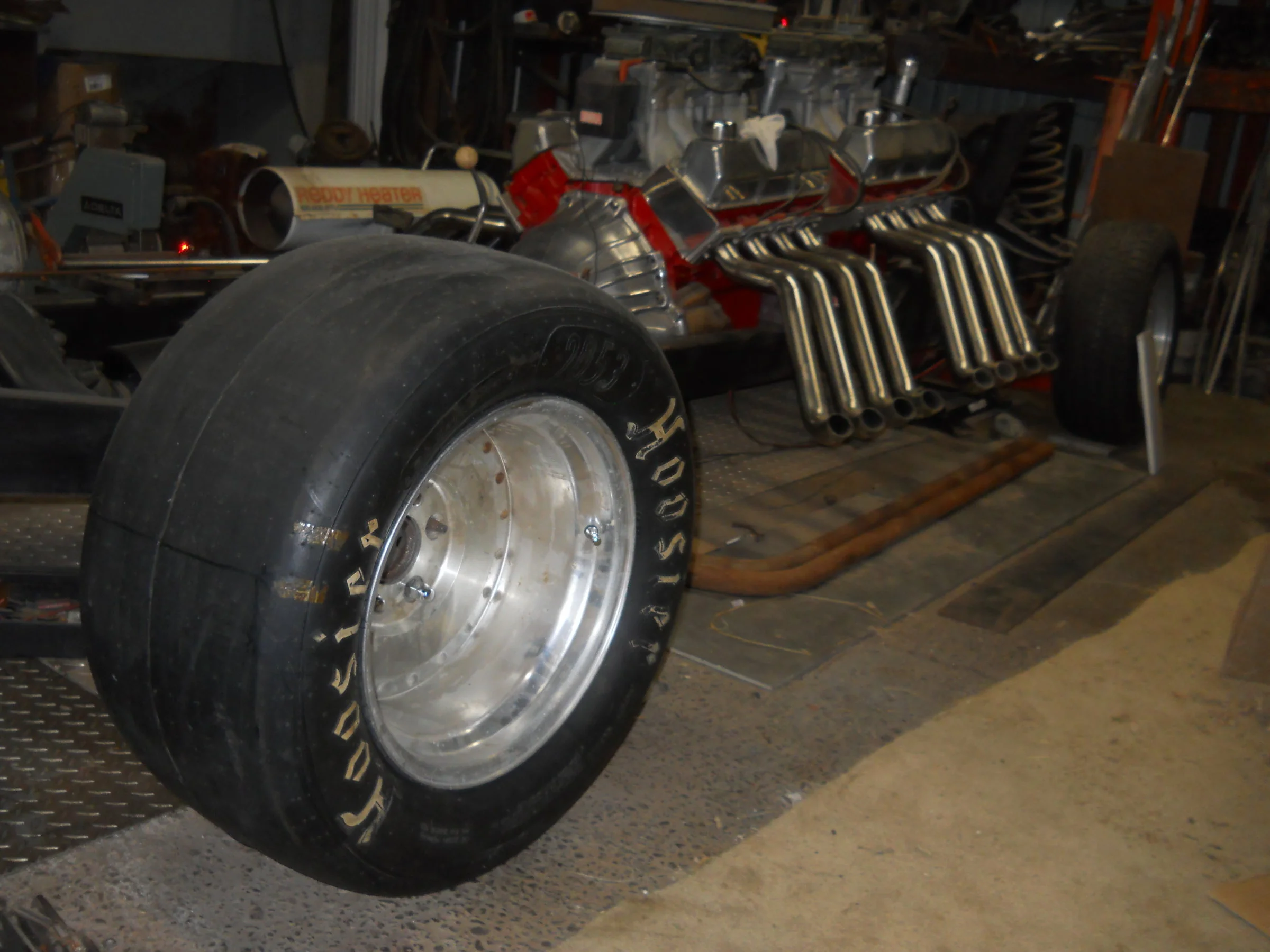

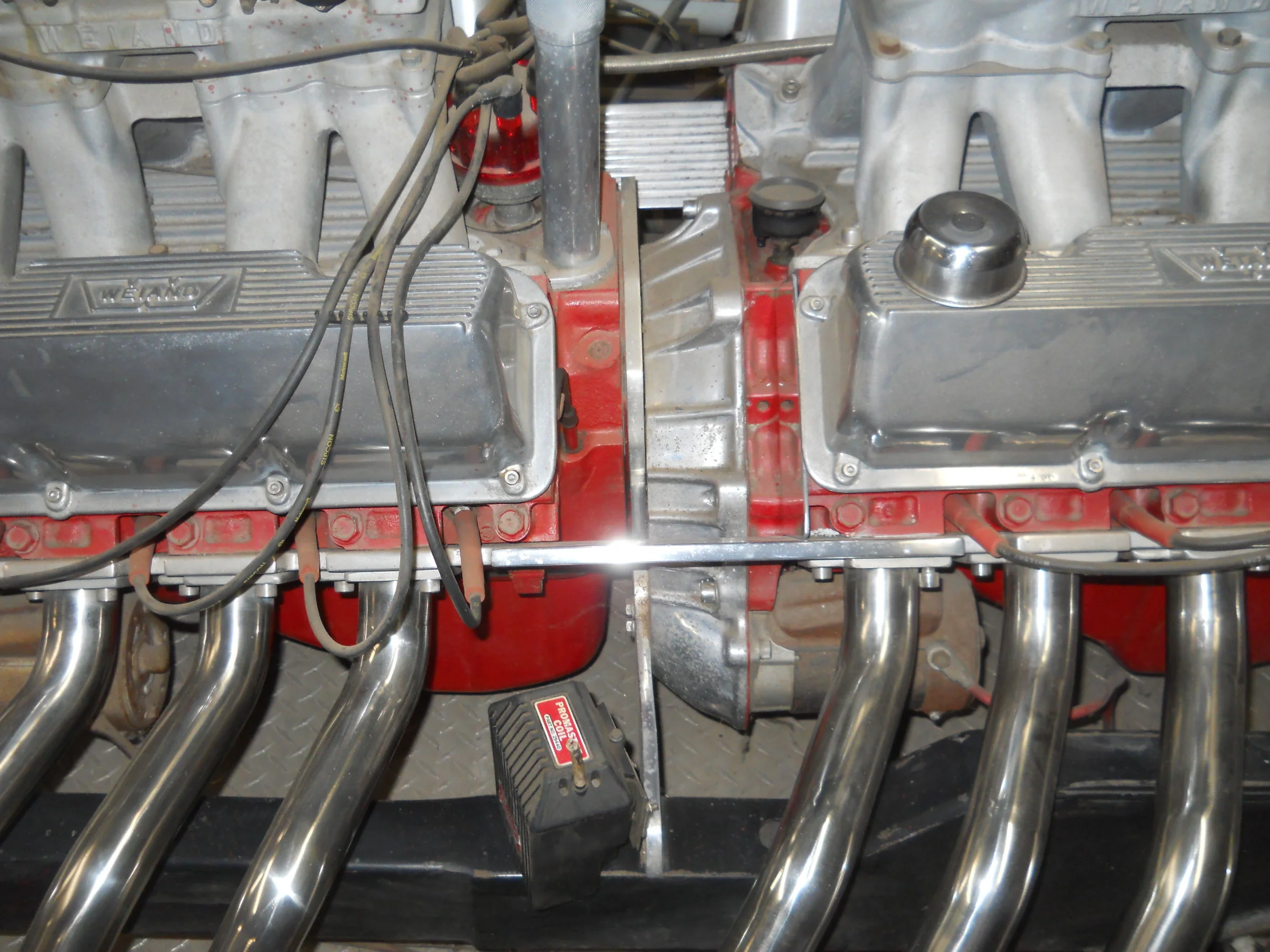

Hey, is a very nice wagon, I used to drive Ford wagons when the kids were little, wish I still had some of them, last one was a Country Squire, 1977, bought it new and still have the 460 engine sitting in a storage shed. Also have the 9" rear under my radical modified 67 fastback.It had 4 whl. disc, two tanks and every other option, was built as a Ford reps car.

Wow! My dad had a 1977 country squire! It was green with a green interior and his teenaged son (that would be me), ruined it. It had the 400m in it if I remember correctly. If I ever find one and I have the money I will buy it.
