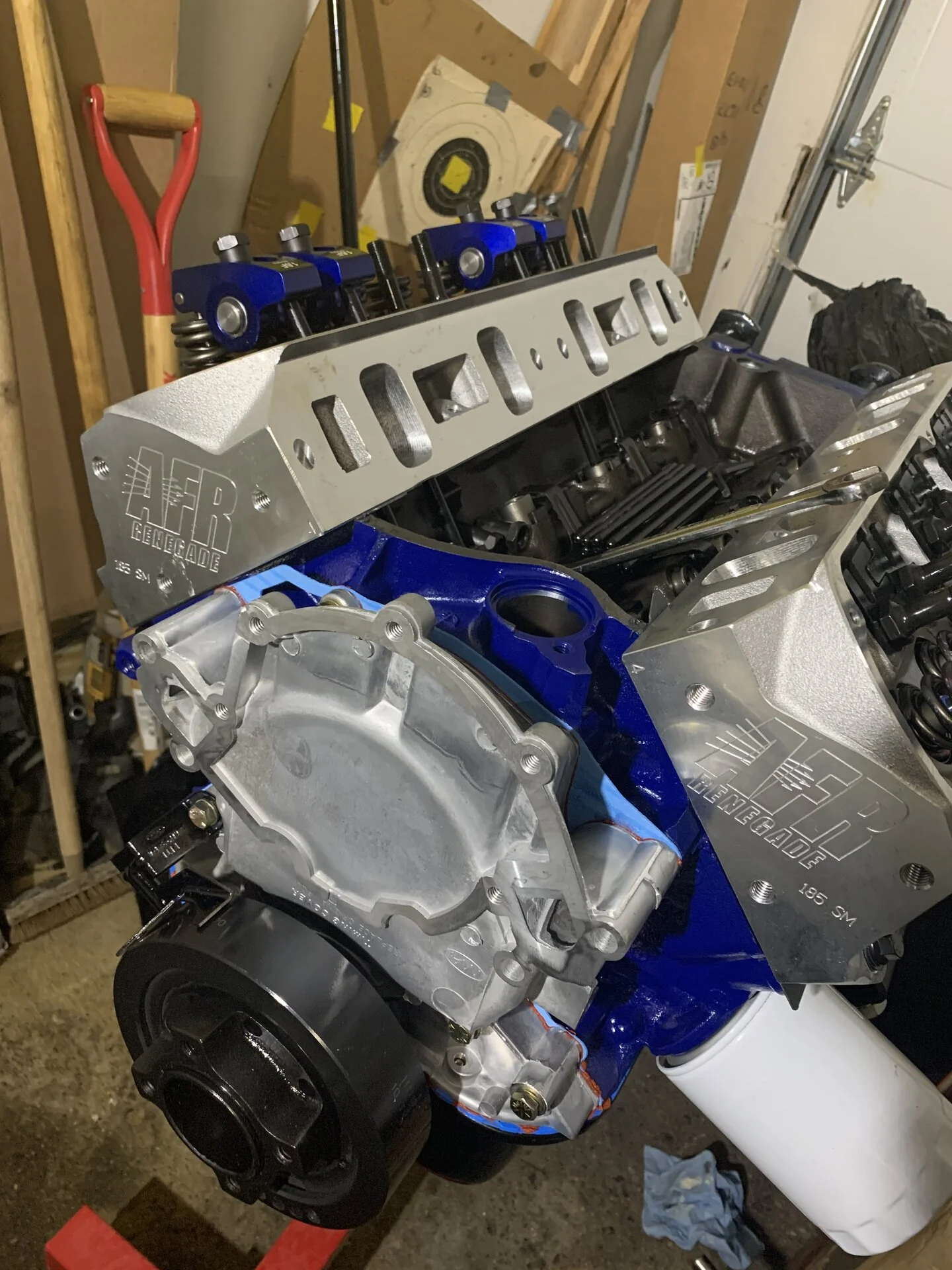

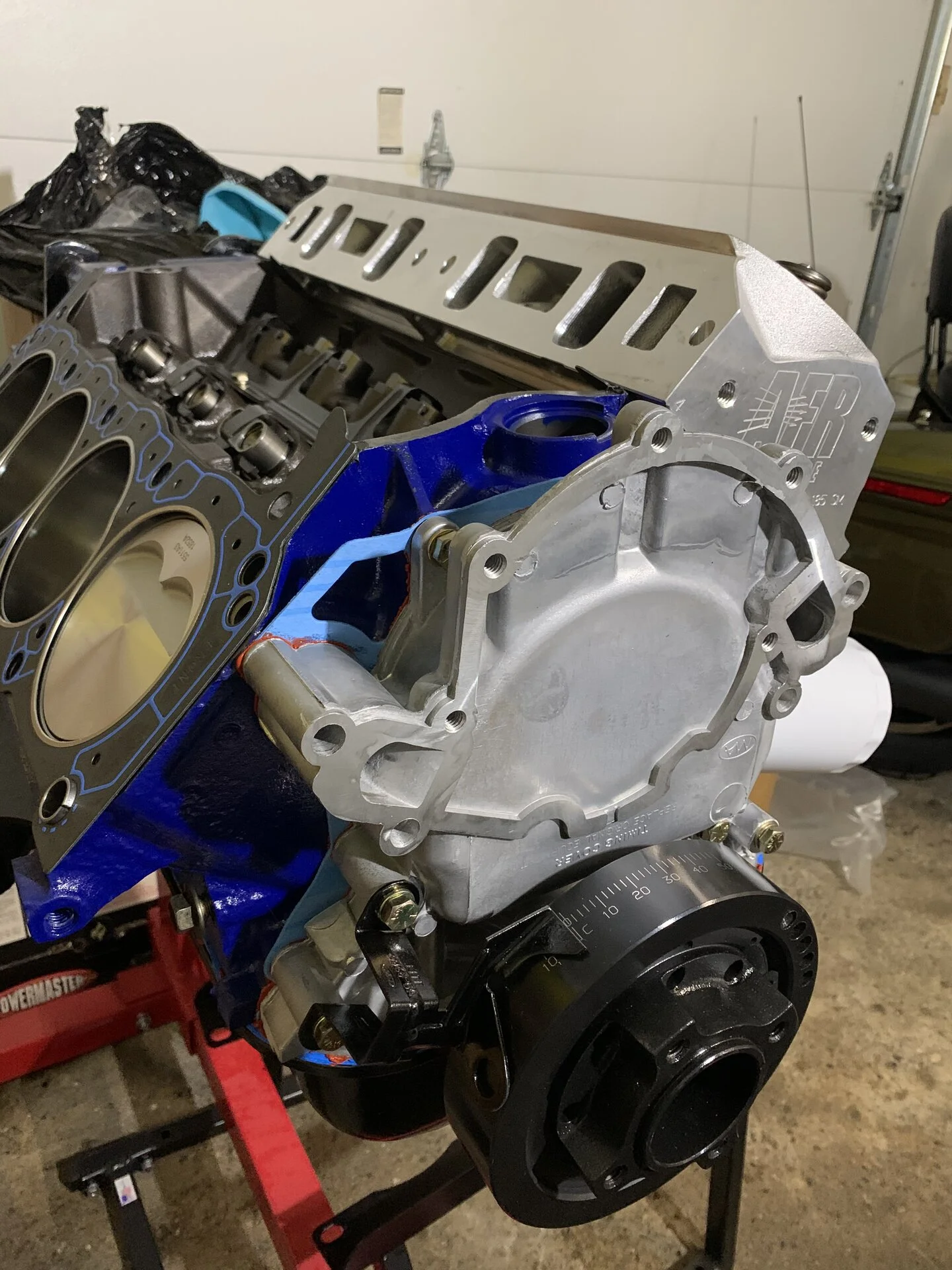

Finally got my heads. Coming together fast now!
