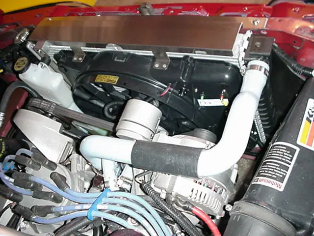

ramchargers fan on a griffin 31x19. It can be modified to fit what ever. I have a friend that runs this fan on the stock radiator.
attachment.php
attachment.php
mustangdaren, thats a mean machine. ya that fan is my second choice. im trying to find one that will fit with little to none,modifications. i dont want a collection of fans laying around.
