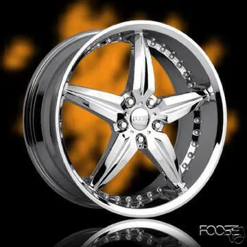

This is supposed to be lighter in color but doesn't look it in this pic?
