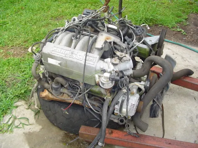

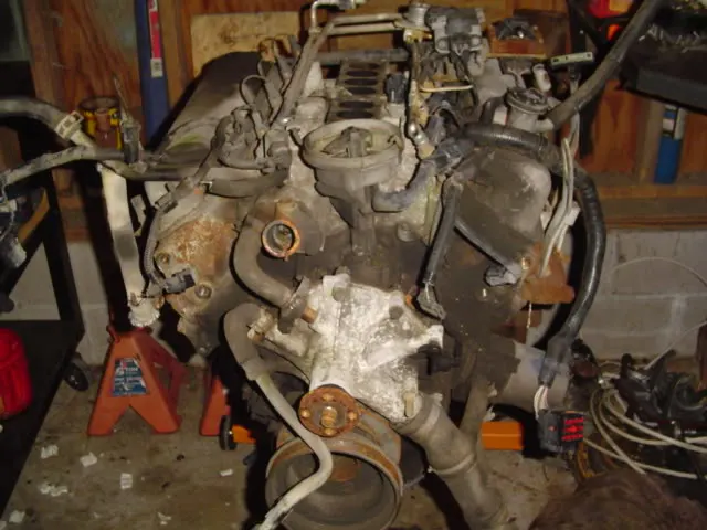

Well, I've decided to stay with the 351. I tallyed up all the cost and it won't be much of a difference after I sell off all my 302 stuff I have laying around.
That being said, I ripped off all the F150 crap from my motor and threw it on a stand. Pulled the water pump off and the balancer and that's as far as I got. I'll start a new "build" thread when the real progress starts.
Here's a couple pics of my new beast:
Filthy!
No, the ports on the explorer intake are staggered while these ports on the lower are straight. I wish it could be done, would save me some cash! And there's no way I could have used the truck upper on my car, it'll would have stuck up a good 6" above the hood line!
