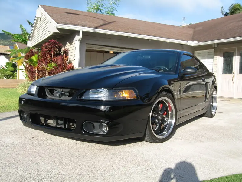

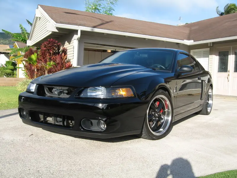

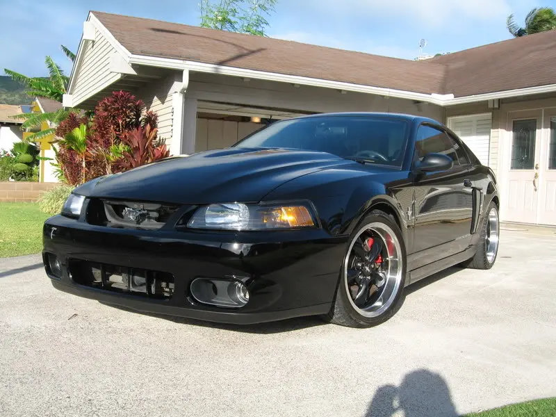

Well I went with the 18's because they look better in the wheel well IMO. I went with 9" in front and 10" in back with 265/35ZR18's in front and 295/35ZR18's out back. I went with 295 because it was as wide as I could go and keep the same tread pattern in a Kumho MX tire. If you run 265's, 9" wheels in the front be prepared to put spacers in the rack so you don't grind the inside of your rim on your A arm.
I've never heard that before, and I've never scraped any suspension part on the front with my wheel. If you get the correct offset, you will not scrape anything.
