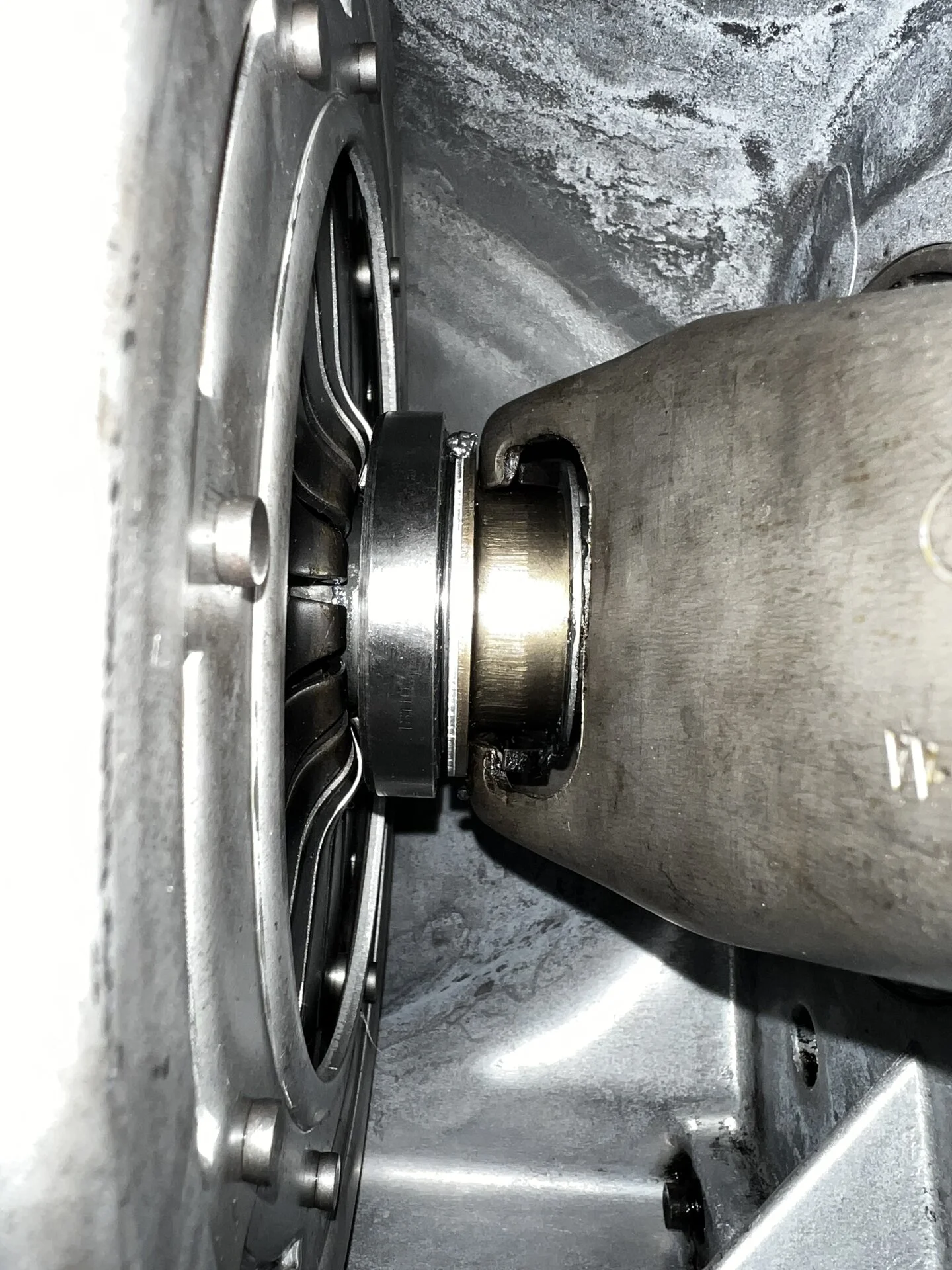

To me, this seems like something related to the clutch fork or throwout bearing is off?
You should be able to see the tob through the opening for the clutch fork. The fork is mounted to the back of the tob, if it was on backwards I would think the fork would hit the front of the opening or at least make a ton of metal to metal noise.
It's not hard to do wrong really. Watch a couple vids on Youtube to ensure you put it on correctly. And yes,you should be able to look through where the clutch fork goes to see if it's on right.
Yes, I made note of that from both the instructions that came in the box, and an LMR video, and another photo tutorial. It is possible that I installed the throwout incorrectly, but I can't imagine that I did after triple-checking.
No grinding or metal to metal noise, but something definitely isn't right.
When I go to look through the hole, what should I be looking for?
Look at the orientation of the tob on the fork, the bearing is in front of the fork, so it appears thicker in front of the fork.
best I can explain.

First off, thanks so much for coming to this thread. This community has been a wealth of information as I learn about my fox. I appreciate your help and I'm hoping this is an easy and quick fix, but I'm prepared to pull it all apart again if I absolutely have to.
Ok, so here's a clear shot of the throwout bearing and clutch fork.
There is a bit of slack in the cable when I'm down at the clutch fork. Maybe a 3/8" to 1/2" of play.

Before you tear into it again, i would unhook the cable from the clutch fork and assess where the resistance is coming from. You should be able to slide the T.O. bearing back and forth along the bearing retainer. Also you should be able to check the clutch pedal and cable setup while it is unhooked from the clutch fork and see if there is any resistance there. The cable and pedal should move smoothly. Good luck to you
