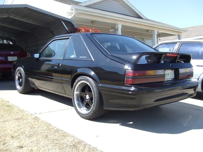

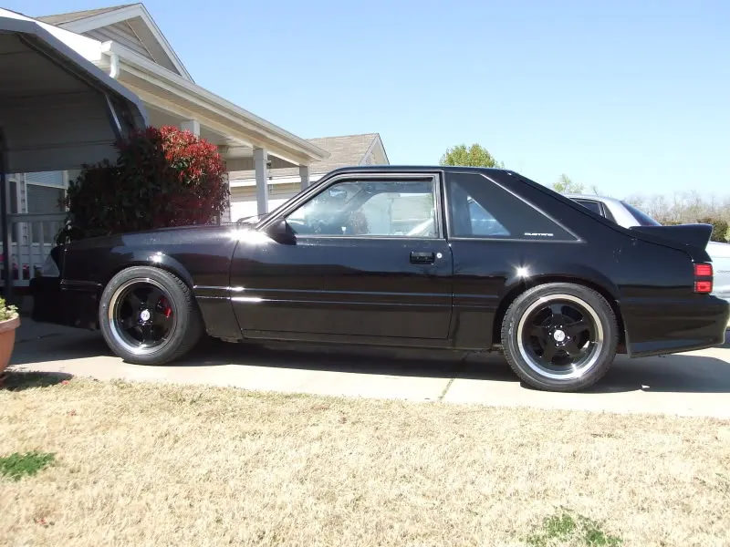

maxspeed springs. they're on ebay for like a bill, maybe a little more. dropped the car maybe 1 1/4 to 1 1/2 inches. the ride is pretty good, especially for how inexpensive they are. i have caster/camber plates but they really weren't necessary. oh and i have urethane isolators in the back, none in the front

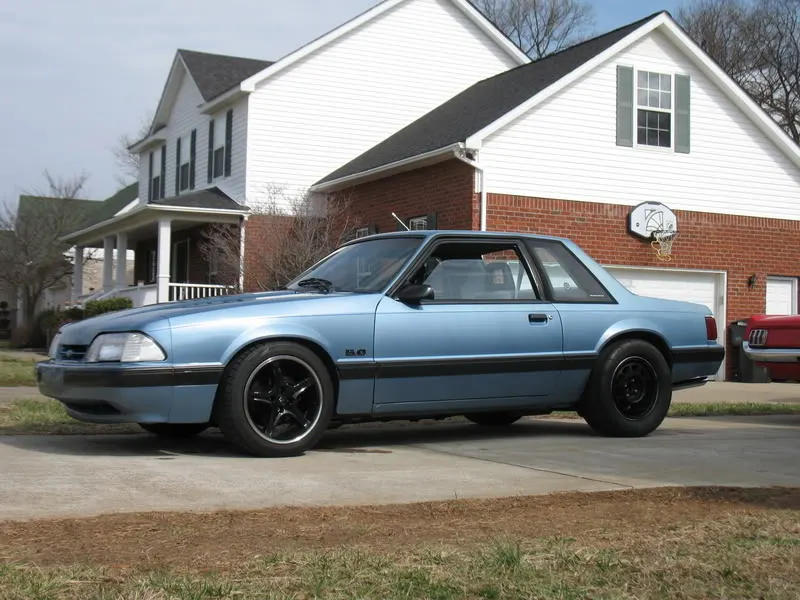

I don't really have any recent side shots of mine, but i've got Eibach Pro Kit springs with 3/4 coil cut off the rear springs to get rid of the raked look so it sits nice and level now.

well the only experience i have with stock springs was coupled with the original shocks/struts which = a chitty ride. so these were a BIG improvement as far as handling and such. they are a little more harsh, but that comes with lowering a car, no matter what spring usually.
