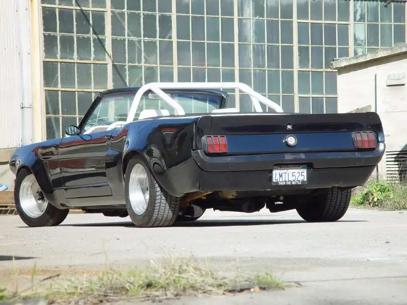

if i end up keeping my stang, i want a roll bar for it too ... there's something about a rollbar that really gets your attention:
