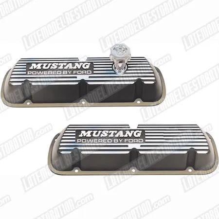

ok so he got back to me, also has some valve covers, from the description they are these:
he'll take $350 for all, or $300 without covers. should i keep haggling?
