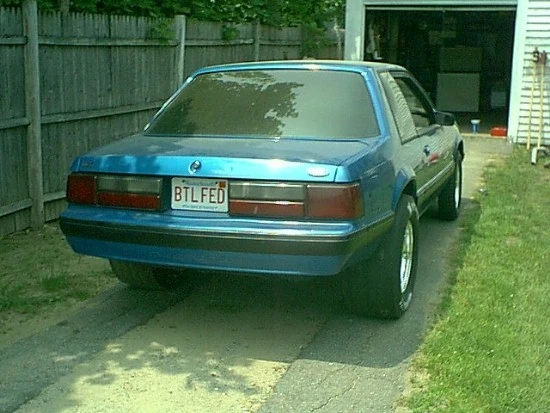

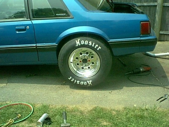

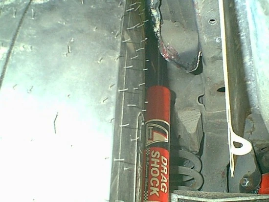

It has been done!
I pounded the crap outta both wheel wells, relocated the e-brake cable, ran a 1/4" spacer and vwalah! They fit. No rubbing, no problems.....just can't break em loose lol. Attached are some pics...tell me what you think!
Thanks for the help,
John
