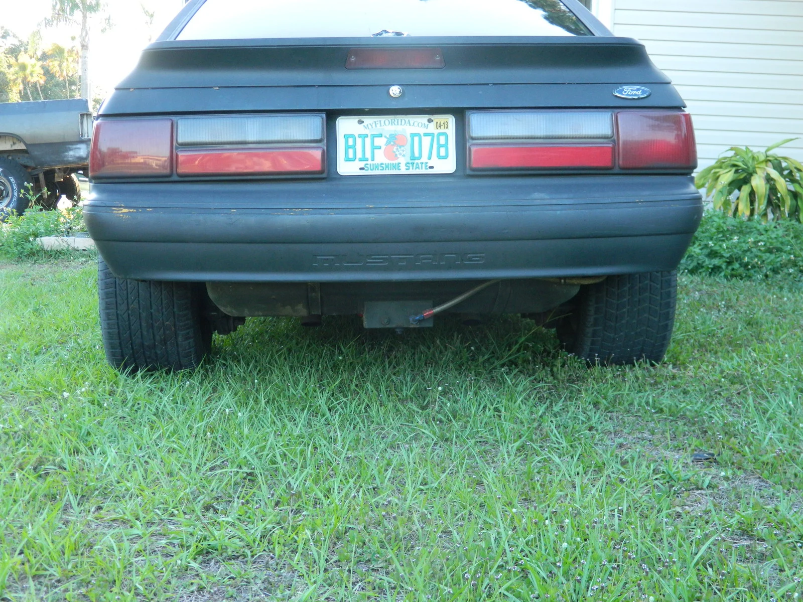

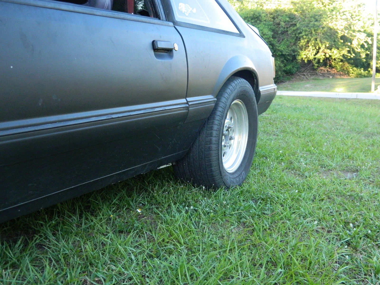

Light weight wheels reduce your et's give better mpg, and argueably less wear on drivetrain. Nothing looks better than a fox with big fatty's in the back. Can upload a rear shot of my car if you'd like.

That looks nice. So in your opinion, would I have to mod much to make the 295/50r15 fit? I was reading about the exhaust possibly being in the way, but I noticed that on my car, the exhaust pipe is short after the mufflers and stops underneath the car.

As you see in the picture, my exhaust dumps before the axle. I just used a hammer and gained a little on the inner fender and curled the fender away from the tire towards the shock. Don't be intimidated, you wont hurt anything. A set of strange ten way direct replacement shocks will alow you to stiffen the shock when you have passengers ect. Has ten preloaded settings and a dial you can reach very easily and you just turn it to adjust. Good for the track and street. Also raises and lowers ride height about 2 inches. You might not rub if you still have a sway bar. that's my next upgrade. See If you can find a used set real cheap and try those out, then you don't have a bunch invested. That's what I did to see If It would work. And the new mickey Thompson sportsman flame tread tires would look sick. If you look at the rear shot, to the bottom left of the fuel tank you can see the knob on the shock used to adjust it. Their about a buck and a quarter a piece.
