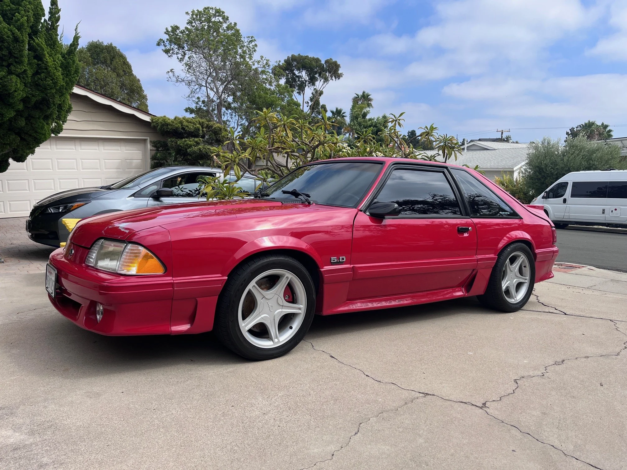

Well, finally took ownership of my 'new' 1990 GT 5-speed after my long winded "Welcome Wagon" post, so i'm going to start this new Progress thread here now that the car is actually mine.
Took delivery 9/22/24

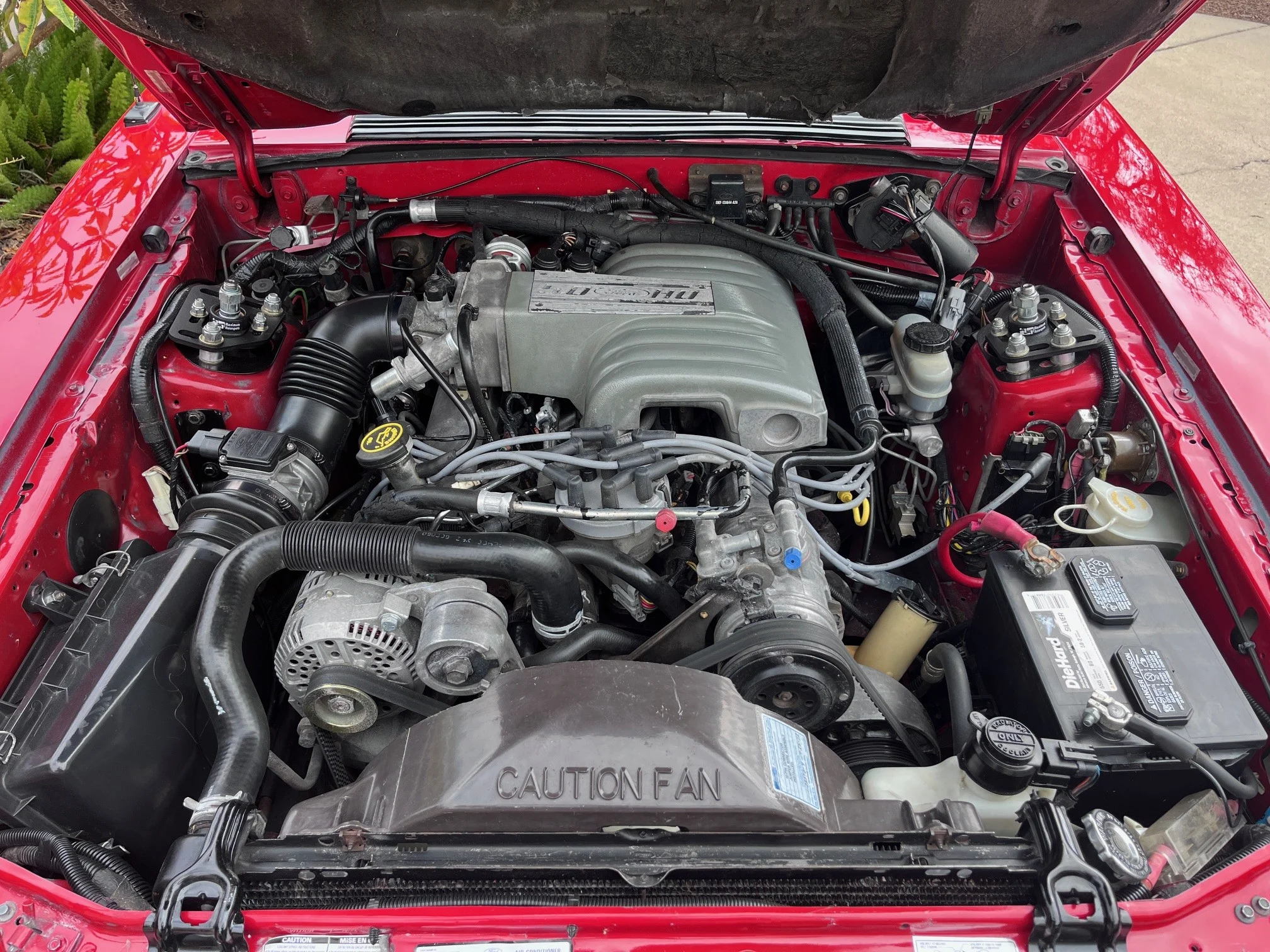

I knew of most of the issues the car had prior to buying it, the seller and I go back many years as I sold him my previous Fox. But, as always, you get in it to drive it an hour and a half home and things pop up. Overall though everything seemed fine, all gauges looked good. Car already has the following mods done to it:
- MM C/C Plates
- FMS Aluminum Driveshaft - this is nice because its probably something i wouldn't have bought myself
- 5-lug with cobra brakes, everything brand new, MM proportioning valve, new e-brake cable
- 3.31 gears
- AP Exhaust Technologies cat back... i think this is like just a Summit brand exhaust?
- JBA headers (mine from my Fox i sold him)
- New tires, i can't tell exactly what they are from the pictures but i can make out "Motive" on one of the sidewalls
- New H&R Springs, he said he took out existing H&R Springs because they were too low, so maybe new springs just not as low
- Koni Shocks
- New McLeod clutch and clutch cable
- New 3G alternator
- New Battery
He also provided me some misc. parts in the trunk which consist of some bushings and sensors, but most notably some 'better' quarter windows. I looked at them, they're not perfect, but do look good.

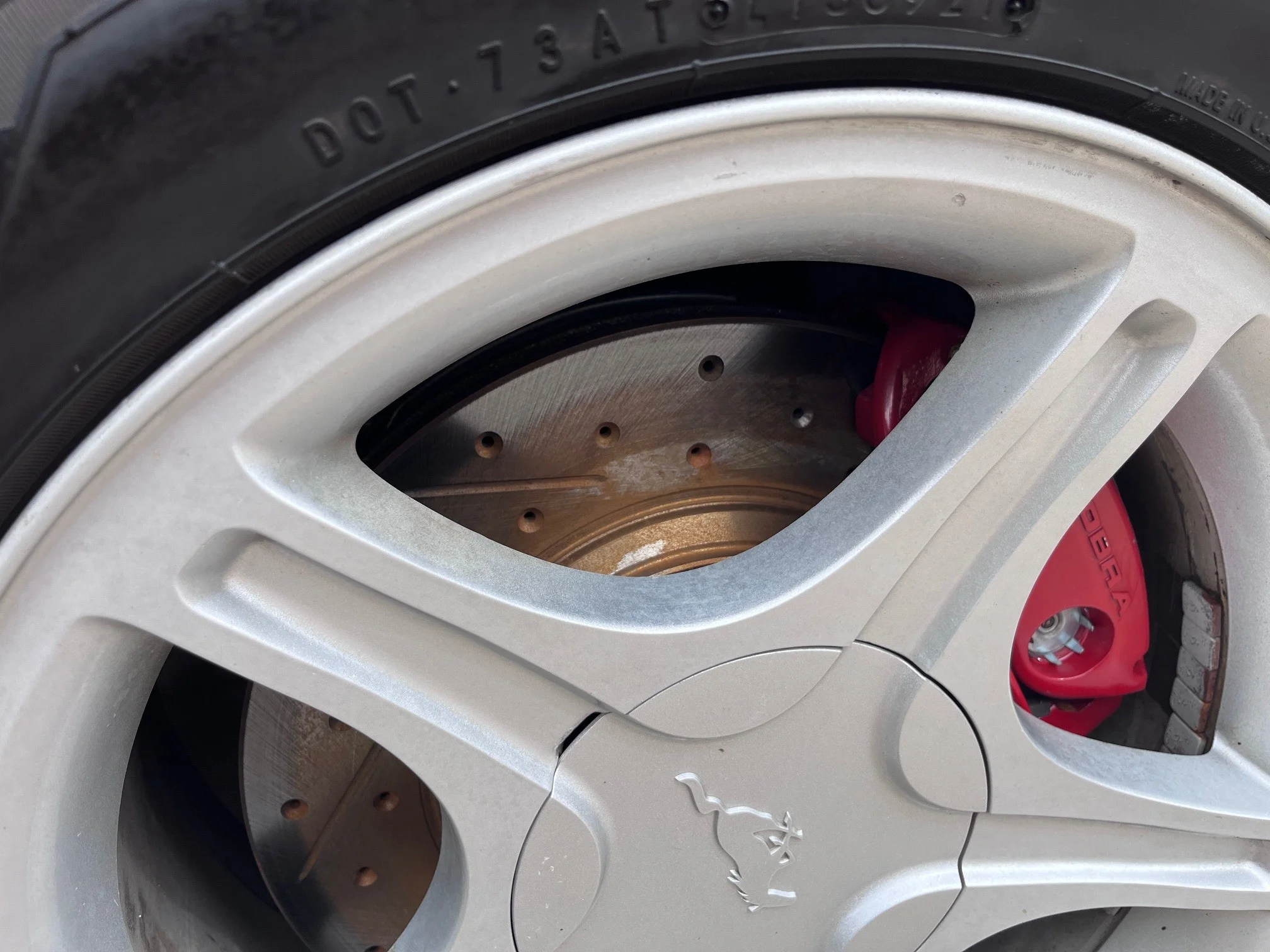

- Drivers outside brake pad doesn't seem to be making full contact with the rotor (pictured above)
