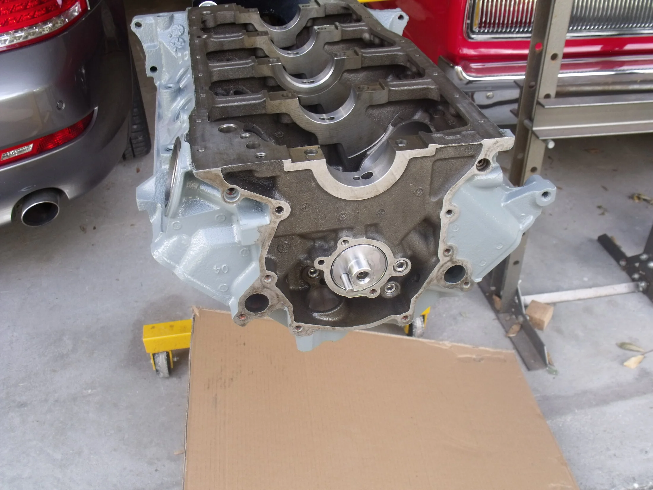

How to remove the freeze plugs behind the timing chain, they are 3 small ones, i dont want to push them in and not be able to get them out. Can anyone help me out?
Hit them on the edge with a small punch and try to turn them, then grab with pliers and pull them out. Or you can use a slide hammer with a sheet metal screw attachment, screw it into the plugs and pull them out that way.
