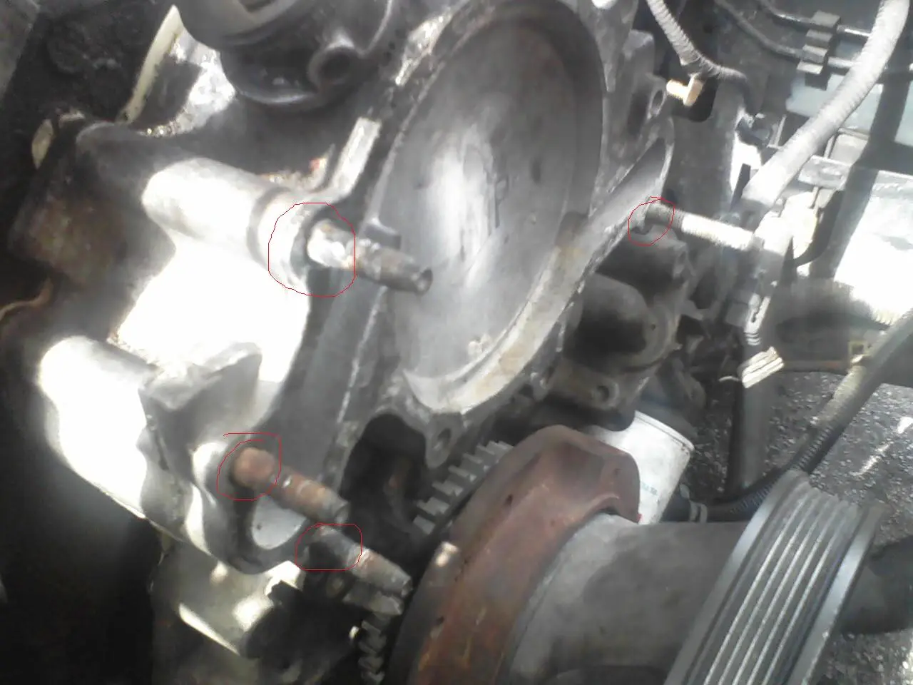

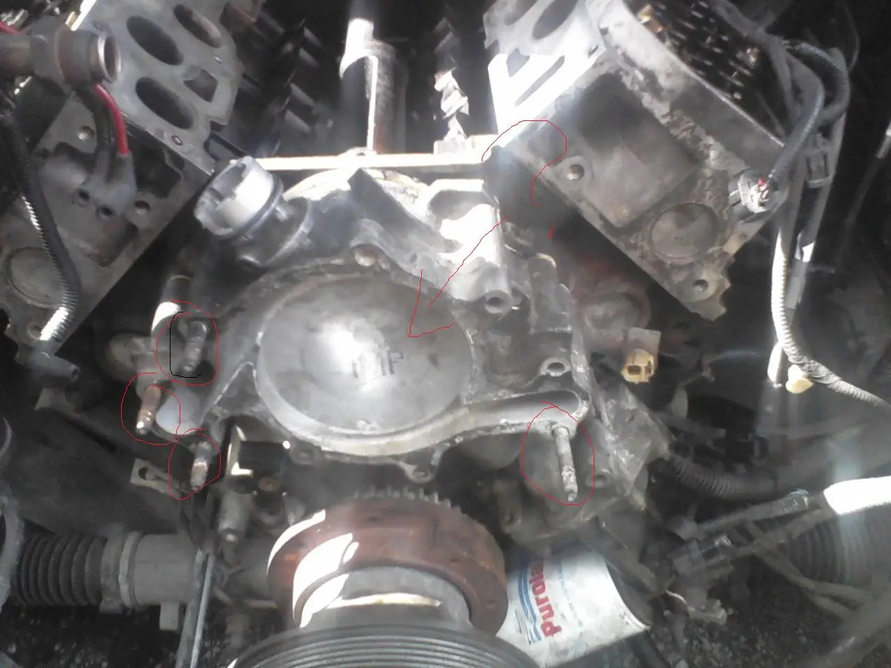

Hey guys I'm back needing more help!
http://www.stangnet.com/mustang-forums/839474-seized-motor.html
That was me and I've decided on trying to drop a motor myself!
First I wanted to take apart the engine to get the aftermarket cam out
to try n squeeze some cash from that... So i pretty much have the motor apart, but this metal on the front won't come off, I'm stuck! It's the part that covers the camshaft as pictured... To me it looks like these nuts were loktited in or something? Once again- any help is sooo greatly appreciated!

The Ford service CD says there a "hidden screw cap". States to mark the size and location of all fasteners
Also states to remove the oil filter.
Recommending getting yourself a Chiltion's manual. The forums can not take the place of a professionally written manual. Worth the price and will pay for itself the first time it's used.
