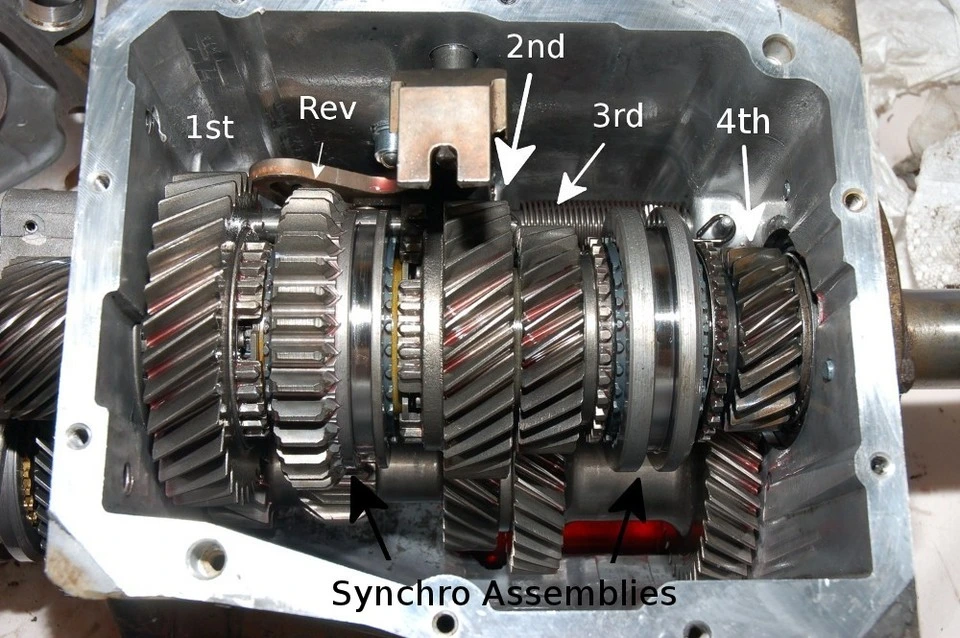

How to rebuild your own t5 with tons of pictures
