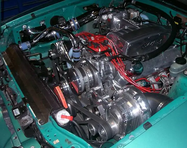

I have a stock cam right now on my N/A EFI but I'm getting my brother's ProCharger P600-B blower. I like the ease of driving with a stock cam but want something that will help my horsepower. Are there any good recommendations for me on production models out there or should I get a custom grind? I don't want a cam that is going to make the car drive like :poo: but I want a good cam.
