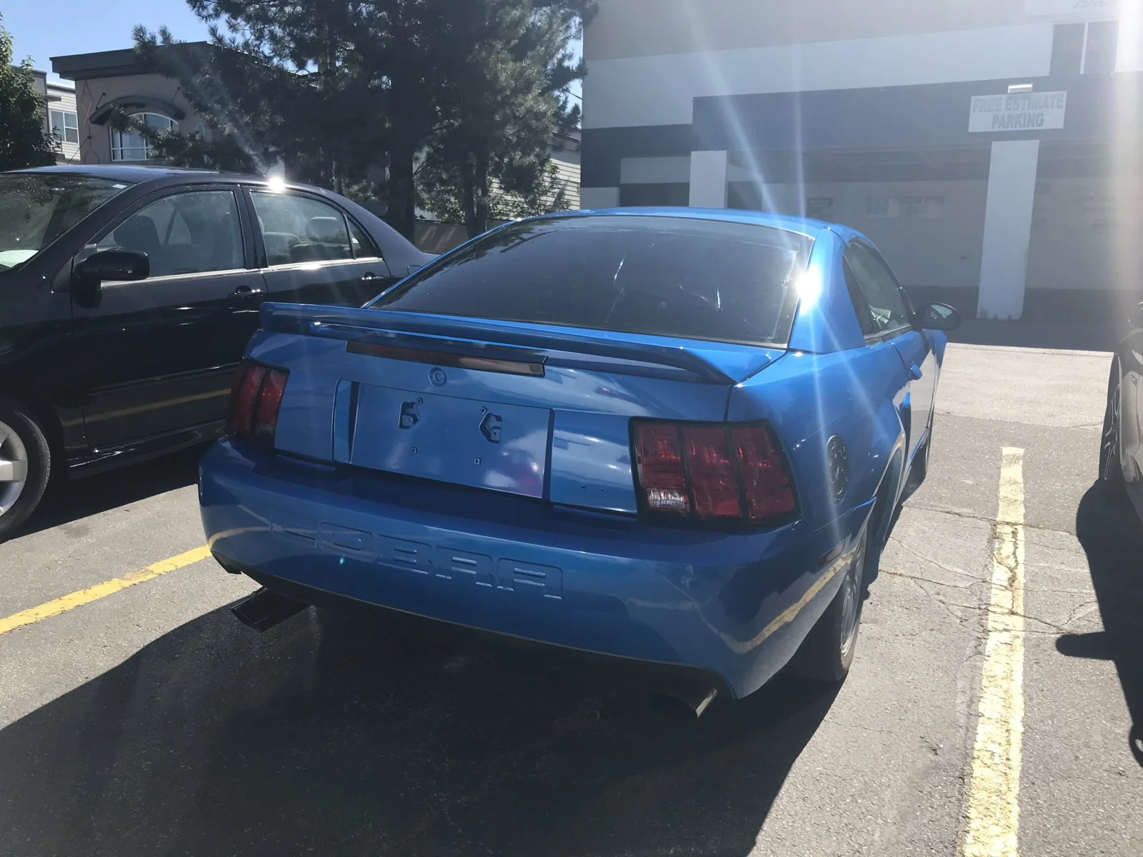

Hi so I have a 2000 Mustang Gt Manual , and I want to supercharge it I have someone that’s experienced and willing to install it for me For $1100 if I buy the supercharger and the conversion parts , 1st question do you recommend me buying a used supercharger off a 03 Cobra? And will it perform as good , or should I stick with Bolt ons , I’ve already dumped a lot of money in this car to be exact 6,415 , also a New paint Job , so I’m definitely not Selling it , what’s a efficient and best way to go and come out with 380 to 450Whp and what kind of bolt ons should I Install before Going Supercharged , Btw I’m posting a picture of the new paint job, and I’ll Keep you Gus Updated , Thanks in advance any advice is greatly appreciated.
