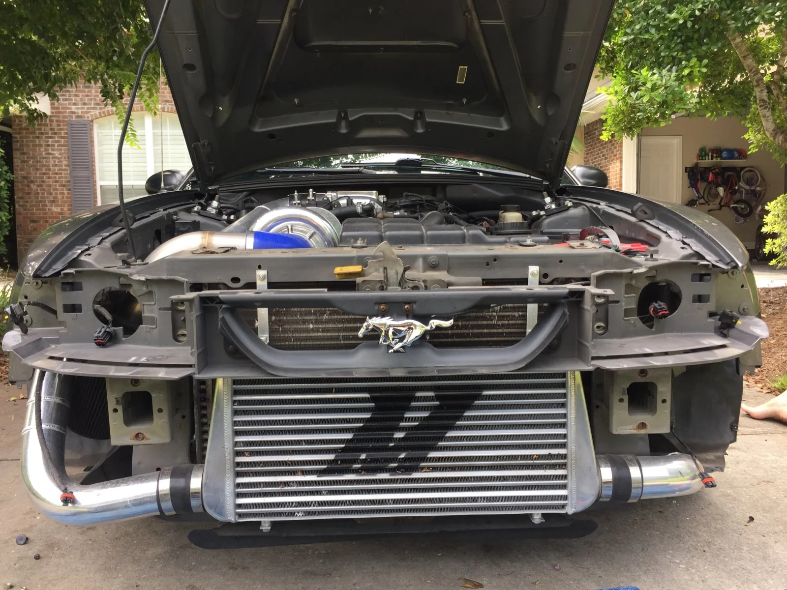

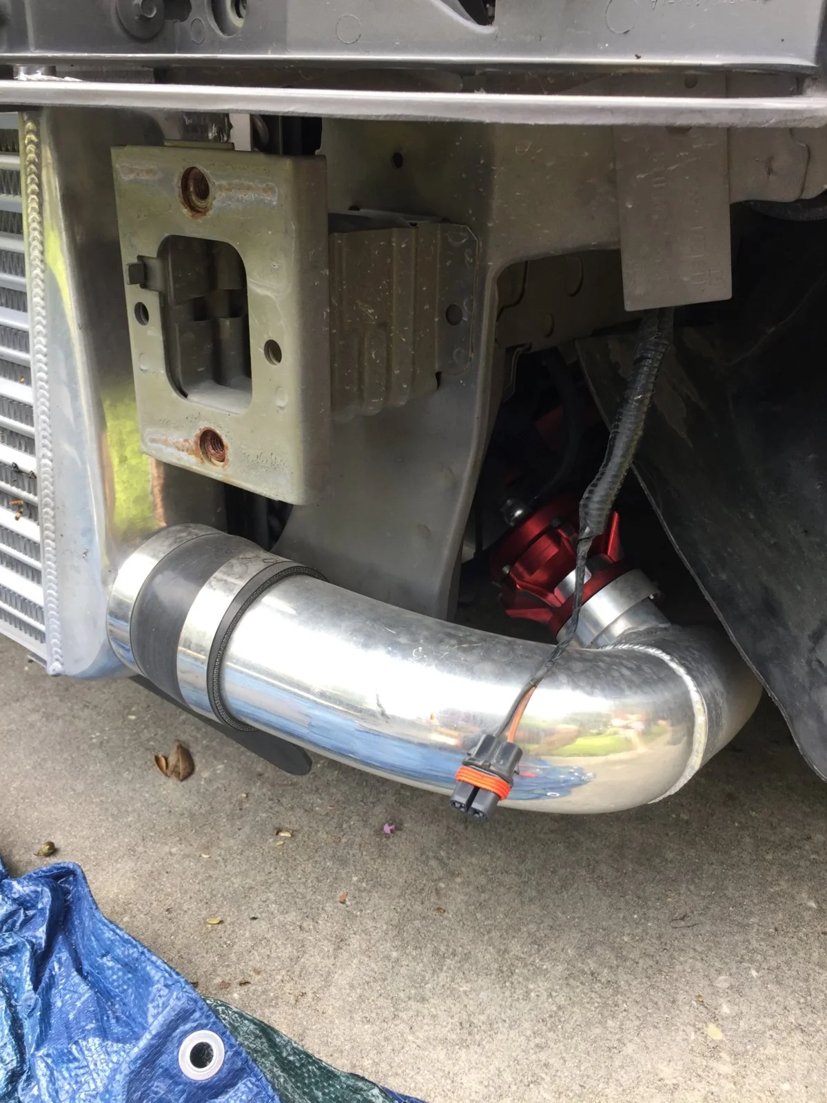

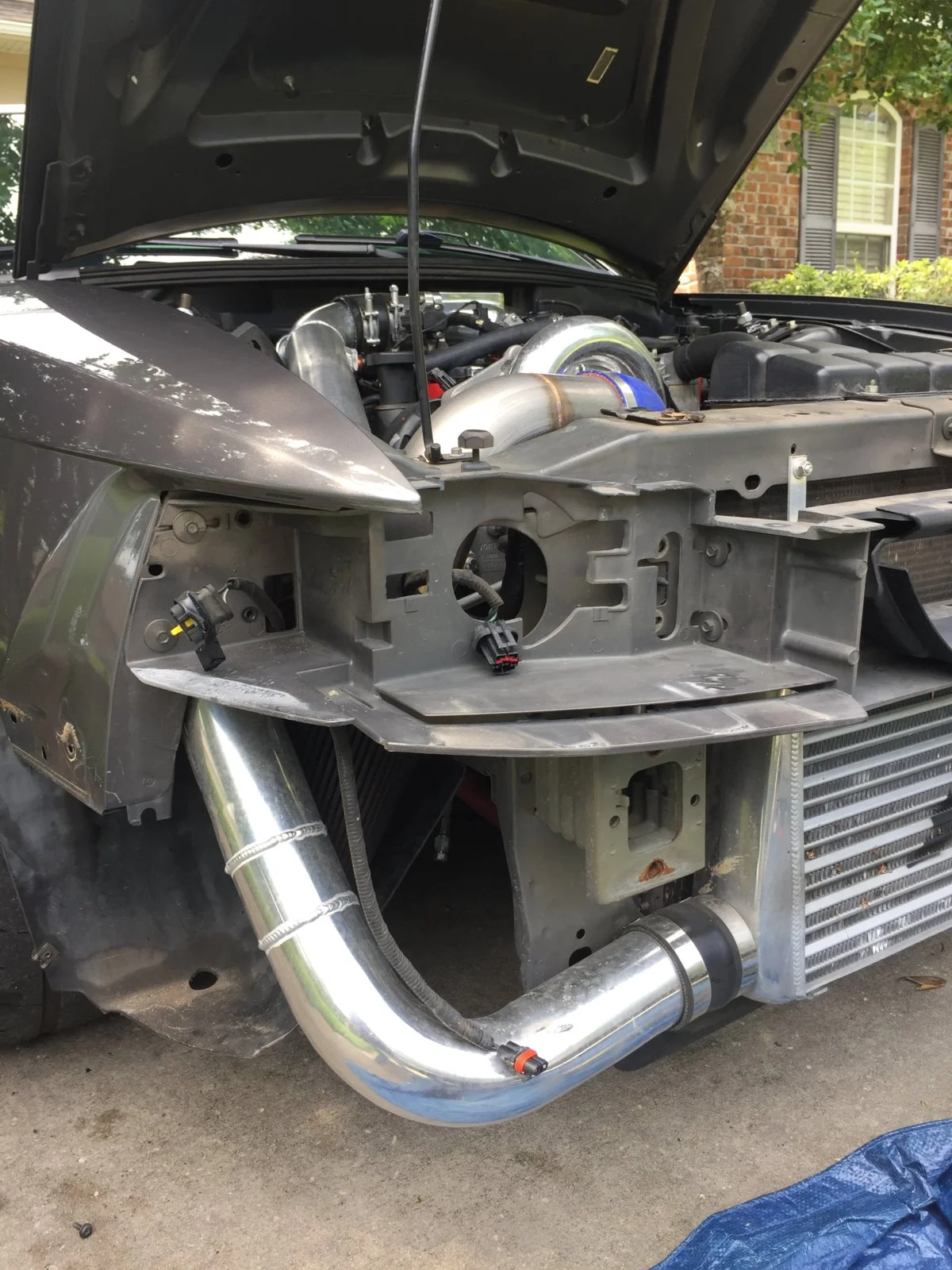

1) intercooling (worth it to find a quality treadstone or mishimoto intercooler)
2) piping (worth it to get quality aluminum piping and get it welded)
3) large powerpipe (don’t skimp on the supercharger intake pipe, get a larger upgraded intake pipe and pull fender air, don’t pull under hood air either)
4) MAF- with above intercooler suggestion I’d go with a blow thru set up like a sct-2600 maf
5) fuel injectors (go with at least 42 lb injectors for stock fuel pressure, 47 lbs gives you a good buffer)
6) upgraded fuel pump (290lph+) or boost-a-pump.
7) air oil seperator for your PCV system
8) aftermarket front bumper support or custom cutting of your current front bumper support to fit a large 3 row intercooler.
9) sticky tires - upgrade to at least a 9” or 10.5” rim in the rear and high quality high performance / max performance tires to handle the power.
10) upgraded clutch - I love my dual disc

Got the polished vortech V3 tuner kit brand new from summit. My daily makes 438rwhp on stock pistons and rods - high RPMs and detonation kill boosted motors - 400rwhp is a good guide for what these motors can take in stock form. Get a good dyno tune and keep the RPMs in the stock range and you should be in great shape in the upper 300rwhp range until you upgrade valvetrain & bottom end components.
