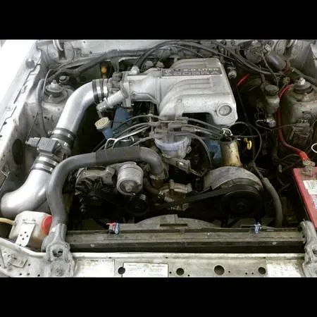

I am looking at purchasing a 89 mustang 5.0. The ad says that the car has an a/c pump delete. My question is how easy is this to fix and what would need to be done in order to fix the a/c so it will work agin. Any help would be greatly appreciated. Thank you.
you will need
a/c compressor
condensor
high and low pressure lines
accumulator with pressure switch and wiring
o rings
tag oil
134
probably the HVAC box under the dash if it has been open to the elements
possibly the A/C relay and wiring harness
new serpentine belt
A/C big and little brackets and bolts
LMRS sells the complete kit to reinstall
rough estitmate to do it right is about $1000-$1300
