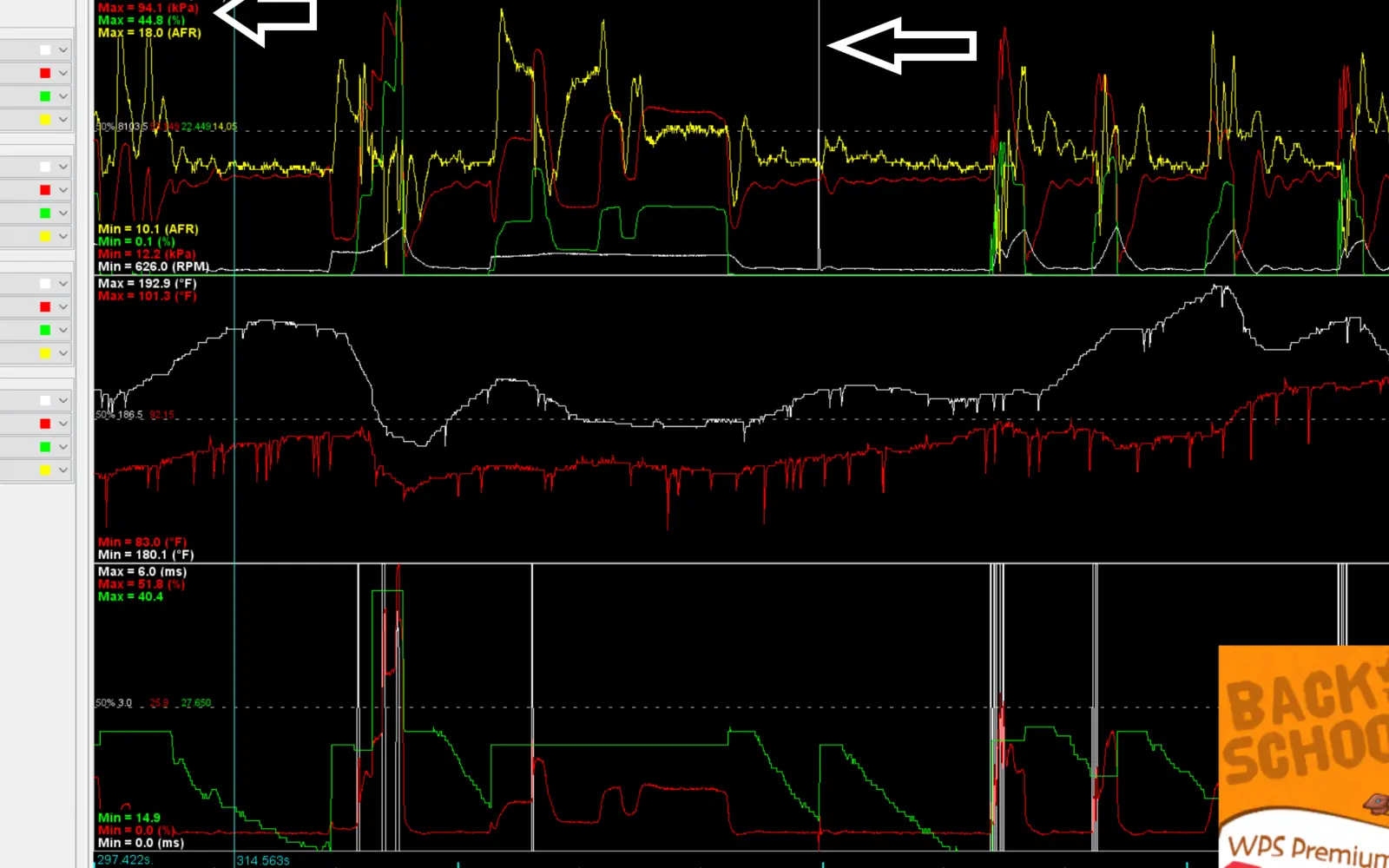

Been having an issue lately and dont know if its tune related or an electrical gremlin. Usually happens with steady light throttle input. The car hesitates for a split second as im cruising along. So far it hasn't happened at WOT. If my picture loads it will be marked with white arrows.

ok your issue may be a few things, the RPM signal into the ecu [from the pip] shows 15000 rpm for a split second this is your hiccup. I do not see the other sensors freaking out so we can rule out an issue at the ecu.
