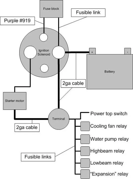

Do you think it wise to run the 6AL box off of a relay? I am planning on having a ditribution block or terminal screwed into the side of my engine compartment. From there I'll have at least 4 and likely 5 relays as shown in the following diagram. I want the electric fan and the electric water pump to have power regardless of the ingition condition, headlights too I guess.
GP, what do you think of this arrangement? I want the fusible links on everything but the starter motor (one with "permanent magnet") and battery itself for safety. Also, does anyone know of a good source for quality relays that don;t cost an arm and a leg?
Here's what I have drawn:
That term "purple #919" refers to one of the wires in my 18 circuit kit from painless-performance.

The MSD box has a built in relay. That is why you have 1 wire to bat power and 1 to ignition hot (to trigger the relay). Are you sure you want the fan & electric water pump to "always" have power? That could put a drain on the battery. For example, say you make a short trip on a hot day (or a run down the strip). After you shut down the motor the fans and pump will continue to operate until the temp hits the shutoff(I am assuming they are on a thermostatic relay). Fans and pumps usually draw alot of amps. I would have their relays triggered by the ignition. You could always put an override switch on them to trigger them when the ignition is off. That way you can control the amount of damage they may do. IF you don't run it this way get a battery with a DEEP cycle :D
Fusible links!!!!!!!!!!!!!!!!!! :nice: You are one of the few people I've ever seen smart enough to do this. Most people don't believe me when I try to sell them on the fusible links. I have fusible links on everything that draws power, even on my relays. Just make sure you use the right gauge fusible link for the gauge of wire you are protecting.
The only thing you may want to consider doing different is running the isolated terminal between the alternator and the solenoid terminal.
Alt --------> Isolated Terminal -----------> Solenoid
This will allow your accessories to draw power without going "through" the battery, while at the same time allowing your battery to charge.
