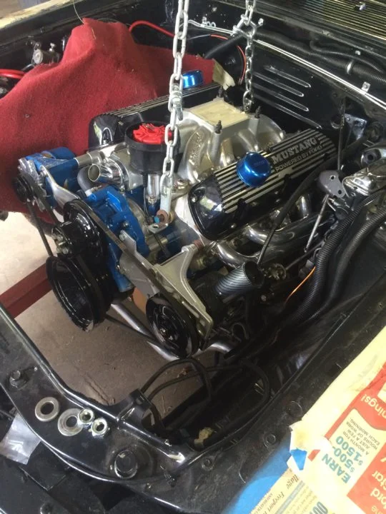

Finally, starting the install the engine! I am having a problem with how the engine sits when it's on the mounts. The driver side sits a little bit higher than the passenger side and the shifter arm doesn't exactly line up in the hole inside the car. Any help would be much appreciated!
We have added new motor mounts so I know that is not the problem below are the ones we're using.
Prothane Mustang Urethane Motor Mounts (83-95) 5.0 5.8 6501BL
We have added new K member / coil over kit
UPR Mustang K-Member & Coil Over Kit w/ 12" 200lb Springs (79-93)

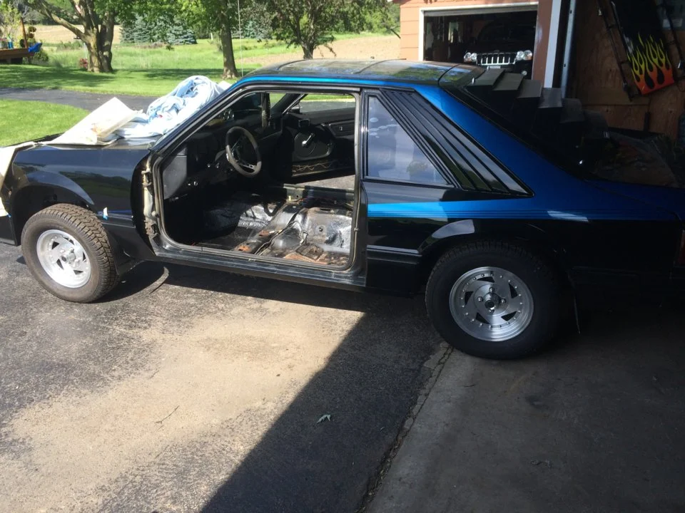

We did however have the transmission attached when we put the motor in, could this be a problem? I have attached a few pictures of the project! I hope someone could lend me some insight here, I'm baffled...
Thanks!

The slots in the k member allow for you to move the engine slightly to make this adjustment. With the trans cross member still hooked up you can loosen both motormount bolts and twist the engine so that it sits plumb in the engine bay
