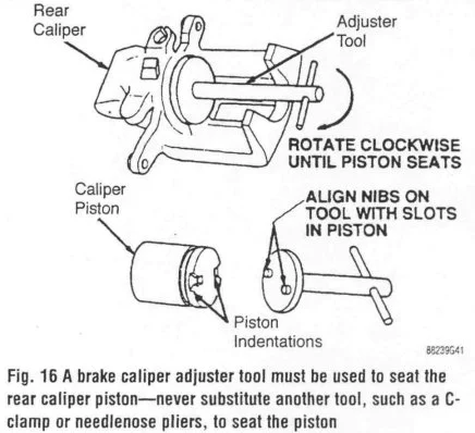

Get a Haynes or Chiltons manual! You can find info and pics like this:

Not the rear. The rear will not go back in by just pushing it. If you ever did, you would ruin the self adjusting clutches in the caliper. The way you defeat the self adjusting clutch in the calipers with built in E brakes is to turn them back in. Thus the tool or trick. Once you turn them back in, you are good to go again.
If you force it in and damage the clutch there, then the caliper would not self adjust. Thus you would have to pump the pedal to get the piston far enough out to give you braking pressure.
