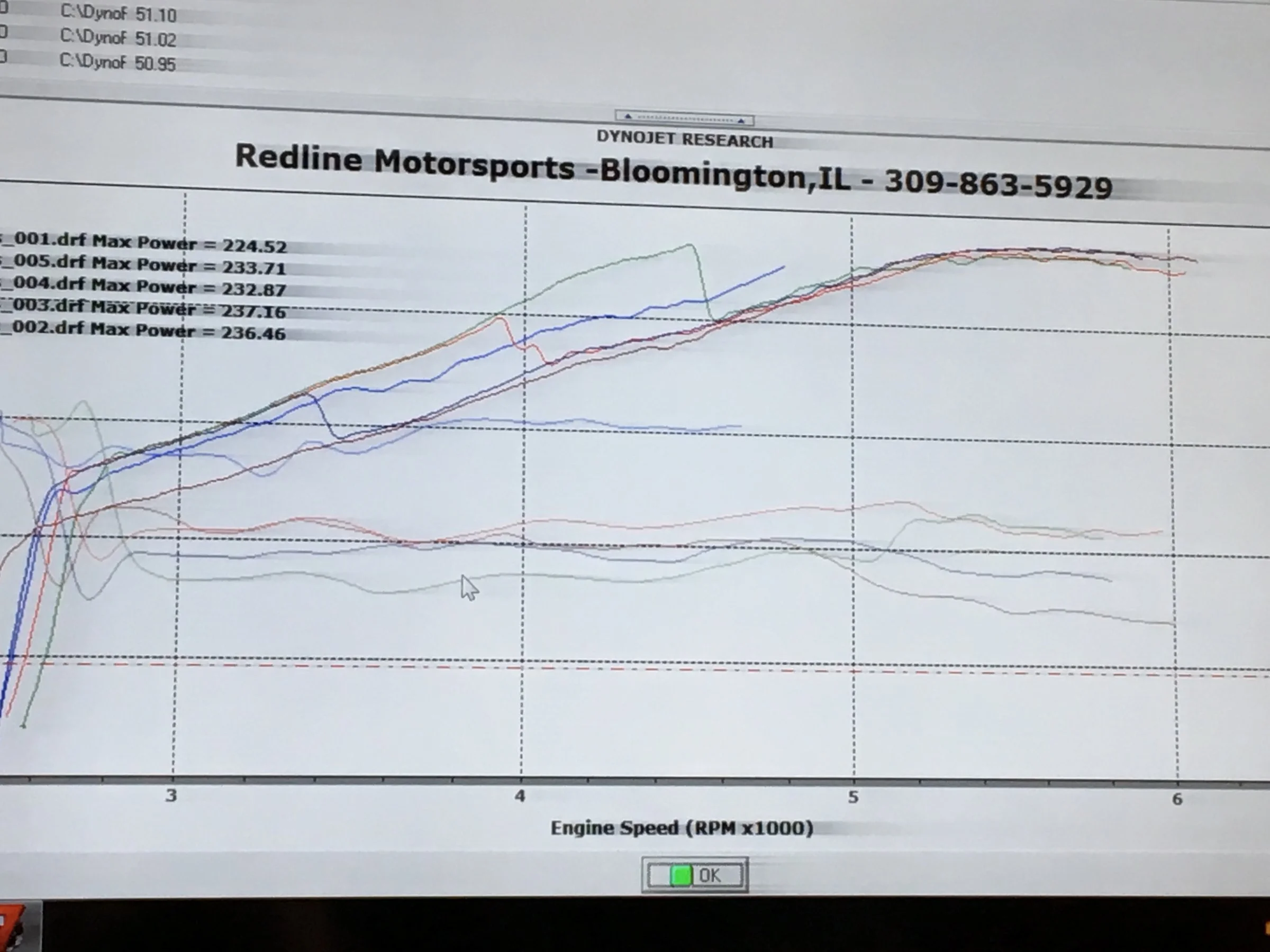

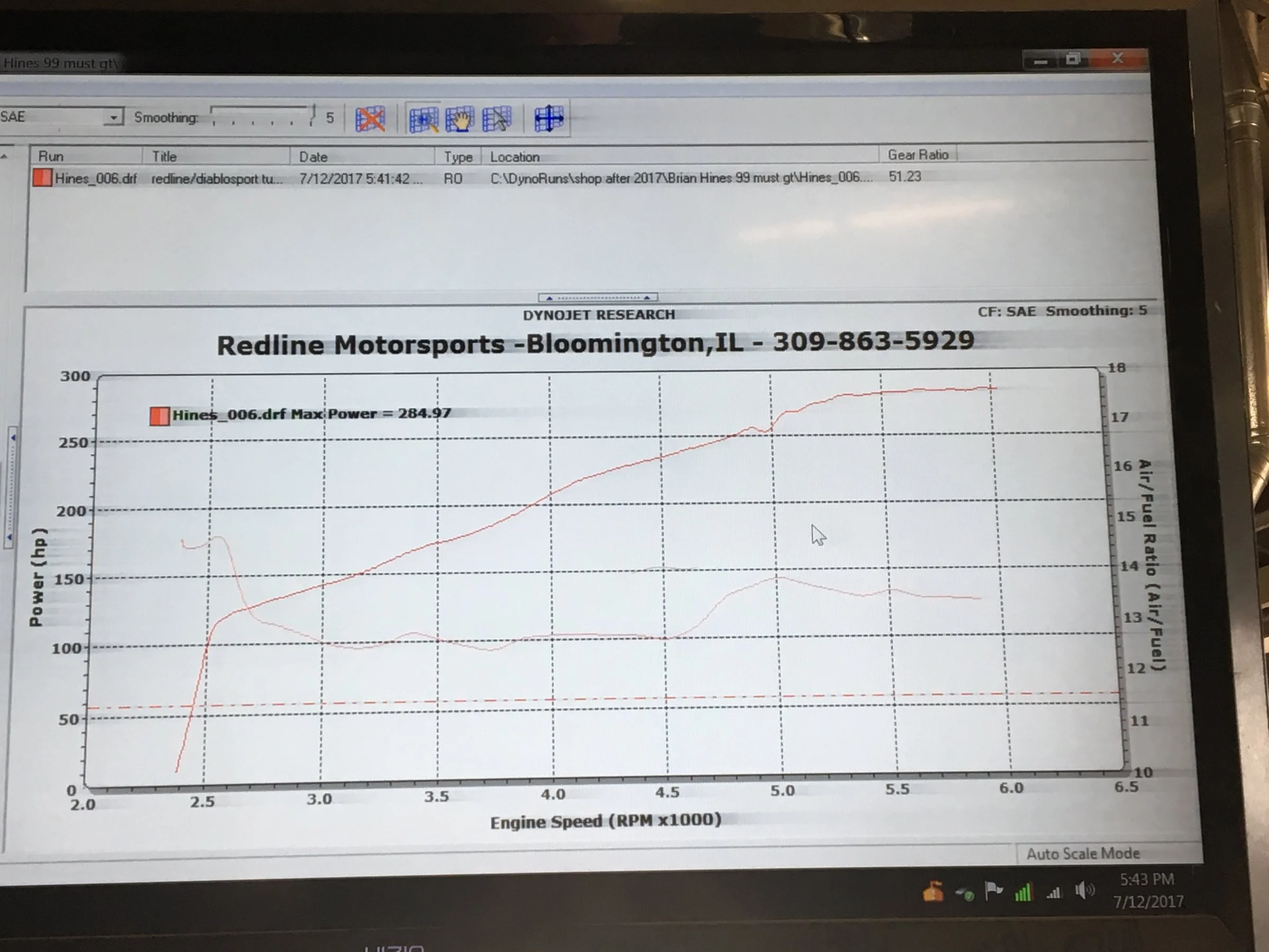

IMG_0362.webp Updated Update. Got back late last-night from Redline Performance in Bloomington,IL. Danny Biggs (Retired from Anderson Motorsports in Clinton) was doing the tuning on my car. He could only get 293 HP out of it. (@345 at Flywheel) A little disappointing. The problem was he couldn't get that with Back to Back pulls. 1st pull was done cool (170*), the second pull was done right after 1st pull(195*). The tune would drop 7+ degrees of timing at 4800 RPM's resulting in a 50 HP loss on the second run. If we left the tune alone and let it cool back down to 170ish, It would repeat the 293. Anyone have an idea what would cause tune to drop timing with 20 degrees hotter temp? I was wondering if the Mark 8 temp. sender in the cross over tube was calibrated different then the 99 GT. Any input will be greatly appreciated.
