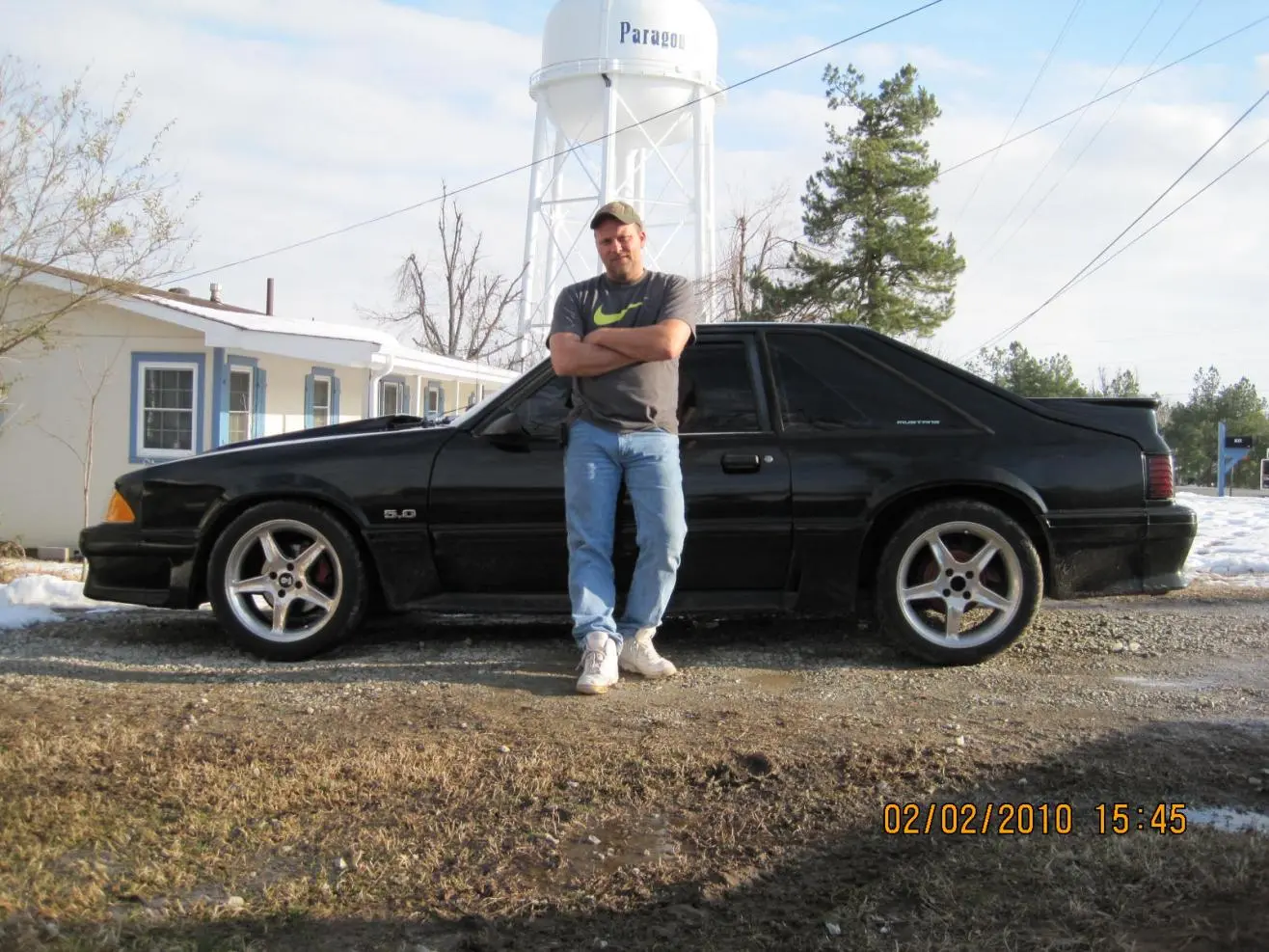

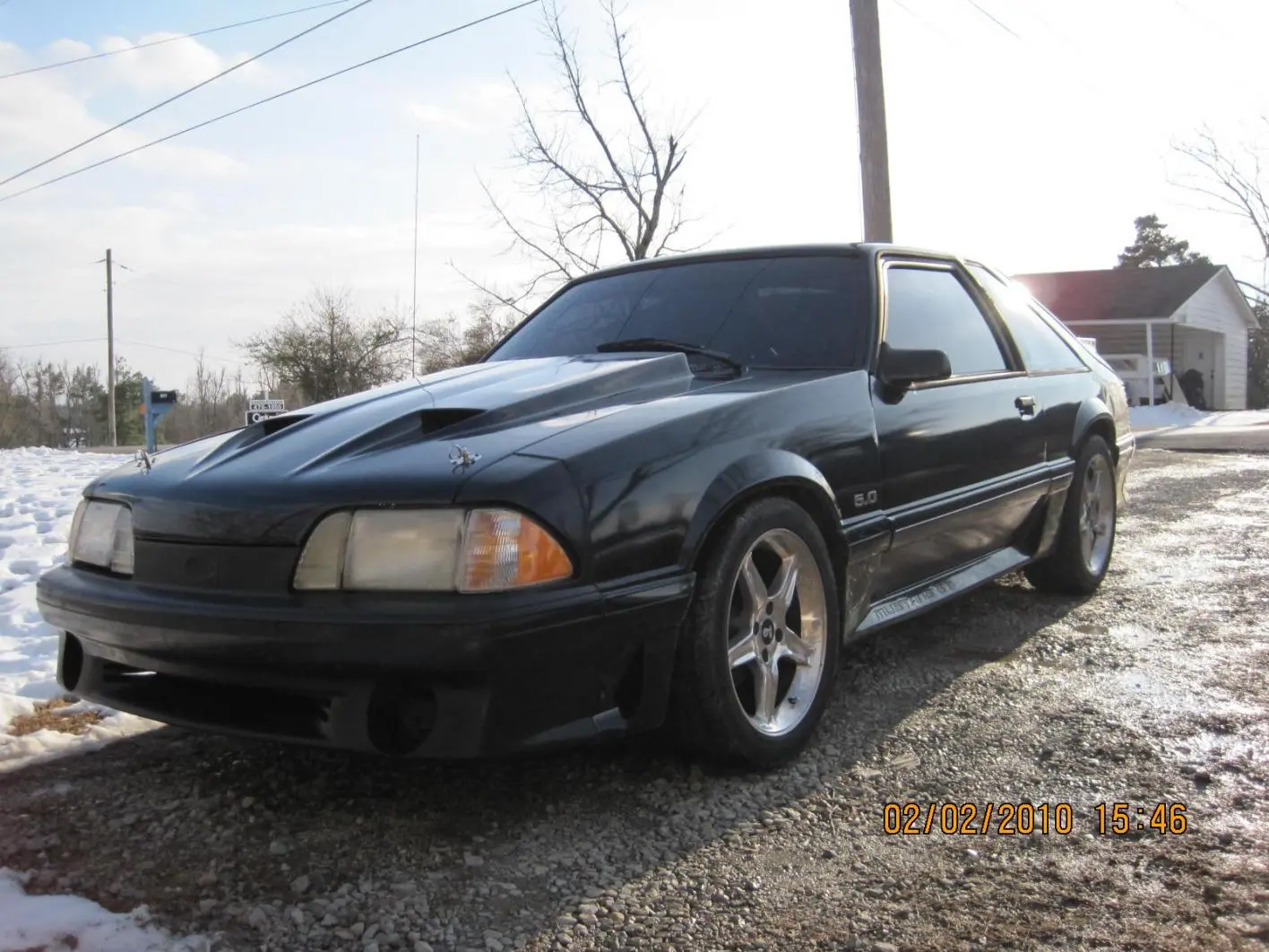

Looks like a nice hatch you've got!:nice:
