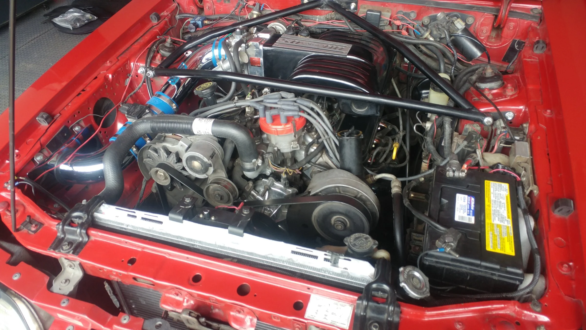

This is the intake
Ok I have to ask do you have proof of what was done to the bottom end? I dont see someone doing all that stuff and then tossing on a stock intake.
I hope you didnt get scammed.
Oh yes there is more then 12k $$ of bills of what was done I bougt the car from a crazy lady lol. I still dont understand why she didnt install the intake even the mod shop recommended it. Anyways thats that. So thats why ill be putting an intake very shortly.
