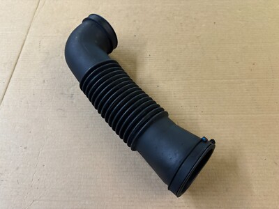

I am in need of replacing my air intake tube on my 1987 Mustang 5.0 LX as there is a tear in this intake tube both at the air filter side and at the throttle body side. Do you guys have a source to purchase a replacement air intake tube? I'm having trouble finding one. If a replacement tube is not available, could you suggest a alternative cold air intake that would be a good upgrade from factory and a bolt in replacement from factory. This is a speed density car for this model year. Thanks.

Check here for a tube
