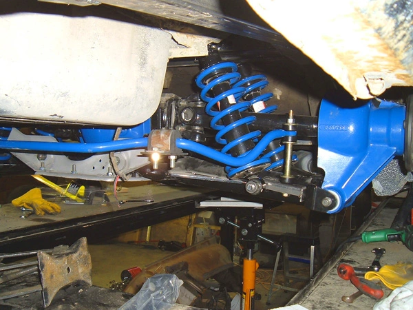

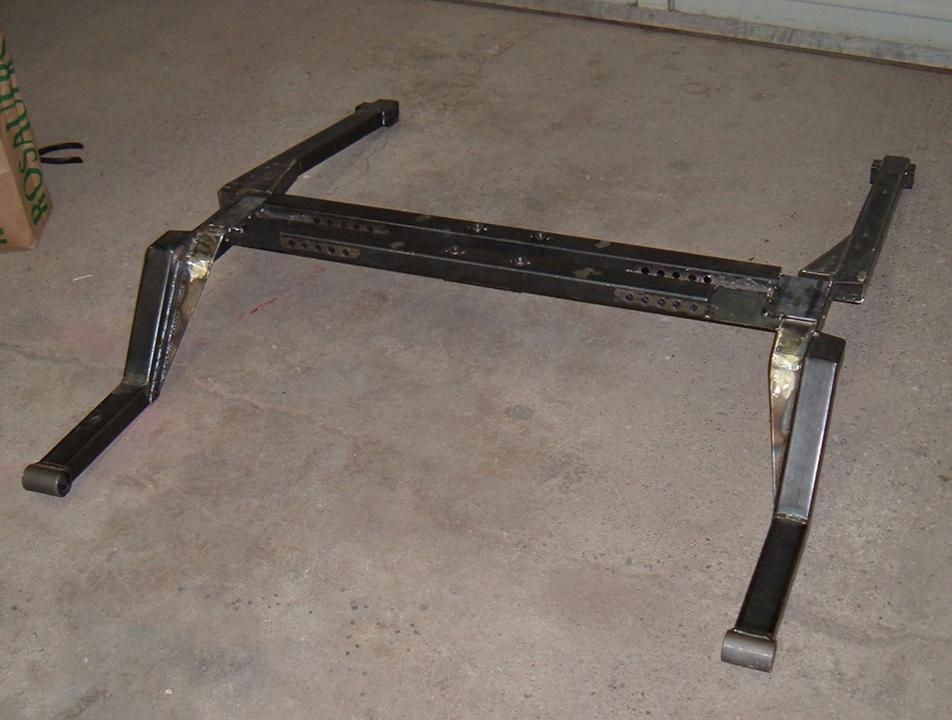

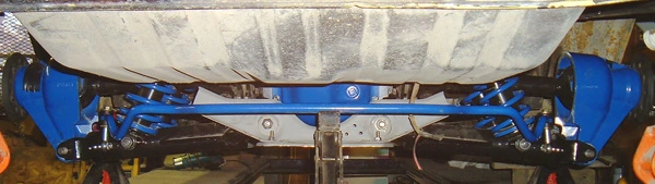

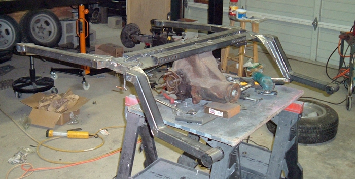

rear end is in the car. Has been for about a year. I got it in and got 90% of the bugs worked out and then went on to do some work on the Galaxie. As promised it is a bolt in and uses the leaf spring mounts as attachment points.
I used the 9/16" front sway bar that came on the car as a rear sway bar
