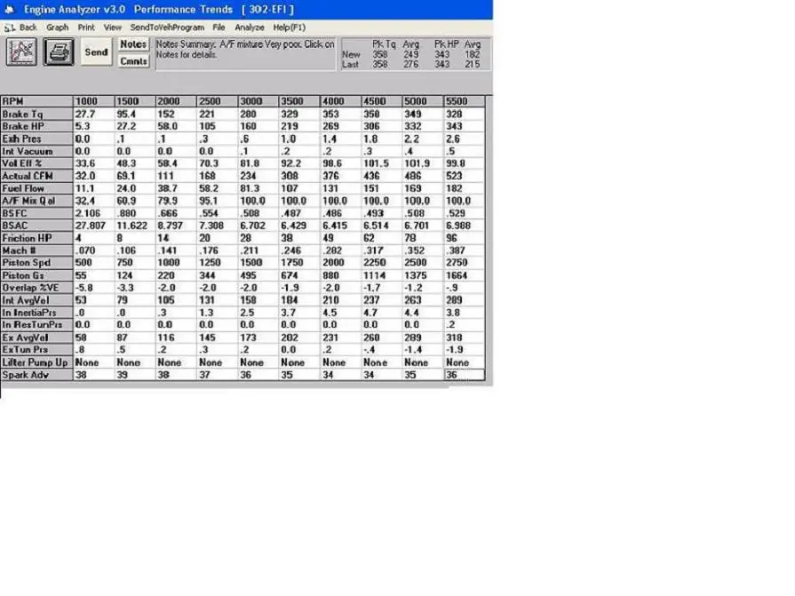

I dunno if you remember me or not(My89GT) from a while back with all the old 289 rod topics about making more HP and compression.But anyways Ive made a few changes on this motor and i got this new program a few weeks ago Called Engine Analyzer Pro. from http://www.performancetrends.com/eap.htm supposed to be the best analyzer on the market and for 500$ i hope so.But i had been thinking about upgrading my heads to some Windsor Jr heads and so i ran a some engine test after Visiting your site to do some comparisons.First off i ran my current setup and it came to pretty much exactly the same results as my dyno pulls showed 321hp@5500rpm flywheel and 351ftlbs [email protected] i ran a few test's that might be some intresting reading to you.
1st Test (My current Setup But my Heads ported to your Specs.)
Heads:E7TE heads Ported with 1.78 Int and 1.5Ex valves.
if you look at current-ported Heads.jpg Note:Vol eff% and Air/Fuel mix qality
Pkhp 343hp@5500rpms and maxtq 356ftlbs@4500rpms

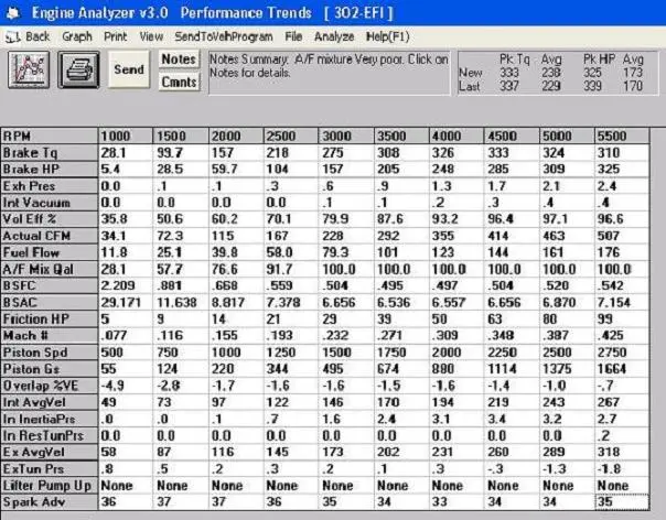

2nd test (My current setup but heads ported to your specs with 1.84int 1.6ex)
again look at current-ported with 1.84int 1.6ex.jpg again Note:Vol eff% and Air/Fuel mix qality
Pkhp 339@5500rpms and maxtq 337ftlbs@4500rpms

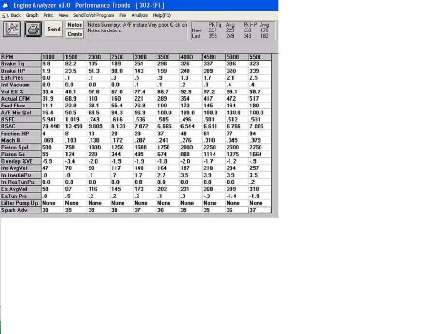

3rd test (My current setup with Windsor jr Heads Bolted on.)
again look at current with windsor jr heads.jpg in next post, again Note:Vol eff% and Air/Fuel mix qality
Pkhp 325@5500rpms and maxtq 333ftlbs@4500rpms

Conclusion:With my Current setup,my stock heads with just a slightly Bigger Ex valve and Fully Ported is Very Effecient With The air Velocity Being kept up,add headers and Biggers Exhaust to get the Air out as fast as its coming in and you have some Big HP gains. :)

Well what impresses me the Most is the fact its theoretically possible for my engine to make more HP with stock ported heads with stock valves than Bolting on a set of Bigger Windsor Jr head with Bigger Valves (18HP more over the HP gains from the Windsor jrs) Just through Effeciency and Air Velocity.And as far as the Engine shes running great but im all bout trying to get even close to the results of test 4 with my changes
