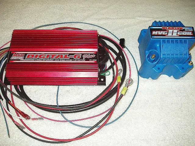

I am running the MSD Digital 6 Plus with there new HVC II coil on mine. Plugs gaped at .070, and work fine.
I cut the plug grd to the center of the electrode.
