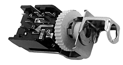

you might have to replace the light switch unit. similar things have happened to me and alls i had to do was replace the switch unit. its not too difficult
the part looks similar to this:

that was going to be my next question. In googling this problem, people with other cars say its there dimmer switch.
Where is this switch on the mustang so i can check it out ?

yeah they arent that expensive. when i pulled mine out of my V6 the connectors were all scorched and the plastic was cracked and easy enough to install...putting the knob back on tho is sometimes a bitch :notnice:
