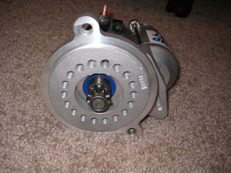

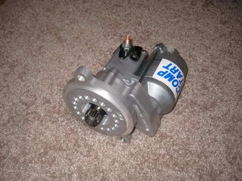

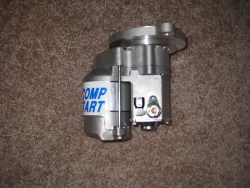

I got my custom High Torque Mini Starter today for my 418W stroker build. It has a built on solenoid so I can finally get rid of that pesky fender wart of a starter solenoid. And uses a denso 3 HP motor and has a 3 to 1 multiplier. Has a billet mount and can be clocked to any position for fitment and does not use shims for alignment. If anyone wants one he sells them for $300 and I can give you his info, he can also make a custom one for your app. They are band new and not rebuilt. Pics below :
