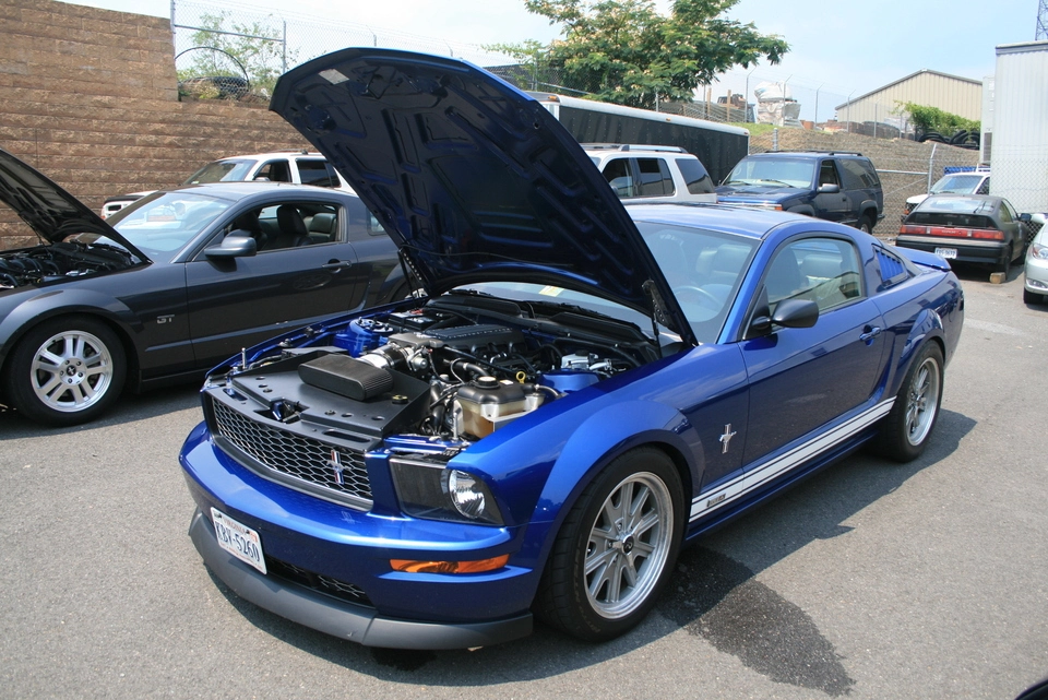

MEEEEEE!!!!! I've had mine for two years now. It does require lengthening the MAF wire harness, cutting/splicing the radiator hose and lengthening and relocating the overflow bottle. None of that I had an issue with or a difficult time doing. Up until last week, I've loved having it as it not only looks different and cool, but also got me to 287 RWHP with my only other go mods the Pypes O/R H and MAC mufflers. Not too bad for an auto running 4.10 gears and 28.3" rear tire! I emailed Doug (Bamachips) last week and asked if my car would benefit from stepping up to the 95mm MAF from the standard 80mm MAF. He said I'd be wasting my time and money as the WMS setup isn't that efficient as sticking to the OEM style elbow. I'll be stepping up to a C&L intake fairly soon. With the ram air tray, the setup sure had a nice look and drew attention when the hood is up

I do think that looks pretty bad ass. But I think for my money Im just going to stick with the JLT. I came up with the money for the intake and tuner, but now that I have that money Im trying to decide if Id rather have the magnaflow magnapack catbacks, or if i wanted to save up longer and get the black fr500 rims. Tough decisions. I wish I had money to play with. lol. Oh well

man your stang looks sick. makes me want to go wax my car in the snow.
