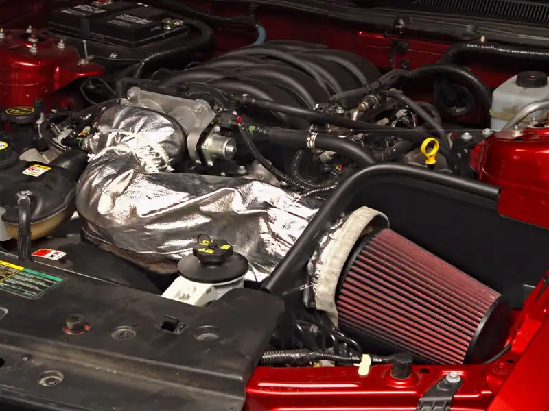

OK, so I just installed my CAI...I got a C&L "street" kit without the inlet pipe on ebay. I am using it with my factory rubber inlet tube (Think Steeda kit, and you get the idea)
Anyway, after driving in to work this morning, I popped the hood to make sure everything was doing ok, and...wow! That aluminum MAF housing gets too hot to touch! Not to mention the rest of the inlet tube wasn't much cooler. Plus, my upper radiator hose touches the inlet tube, right where it connects to the MAF now, so there's more heat...
Granted, it's 100 degrees here right now, so 'cool' is a relative term. So, it gets me to thinking...is my inlet air now HOTTER than is was with the factory setup? I mean, what good is the heat shield on the filter end, if the incoming air is met with a MAF and tube that you could just about fry an egg on?
I have an idea, though. I have an aluminized kevlar fire suit that I bought at a garage sale a few years ago. I've already used it for a few Halloween costumes, so it's time to "repurpose" it! It's one of those types of fabrics that you can take a blowtorch to, while you are wearing it, and it doesn't get hot. My thought is, if I make a sleeve, so to speak, and use it to cover my inlet and MAF, it'll definitely keep the heat out. It probably won't look pretty, but it could prove to really cool down that incoming air charge. Anybody tried anything like this?:shrug:

I am using the Street kit w/ the no-tune insert. THe only thing I'm not using, is the C&L inlet pipe. Why it was ever separated from the rest of the kit, I'll never know, but it was a good price on ebay because of it, and for the extra $32 for the insert from C&L, it was worth it for me at this stage. The guys at C&L said it would be fine to use this way, since everything from the MAF forward is how it's supposed to be. They said you only gain about 5-6 HP from the Inlet pipe, so, I'll tack that on down the road, when I get a tuner and such. Heck, for now, if this shield I'm trying does what I anticipate it to do, I might even be better off this way.
pic added!
Well, like I said, it's probably not pretty, (although some die-hards might consider it to look Race-like! :metal: or is it, SPace-like??:jester: ) but I went ahead and installed it. I figured what better time to test it than when it's in the triple digits outside.
I don't have a code reader unfortunately, but I should at least be able to make an educated guess, if I get all the way to work tomorrow, (25 minute drive) and give the MAF and intake pipe a good handshake, and not pull back a burned hand! :grin:
I'll let you know! It should make a difference. Radiated heat does NOT penetrate this fabric, the only thing I'm worried about is dissipated heat that travels through the TB end of the intake, but that shouldn't be enough to make any diffrerence.
ps. here's a pic:
-gambi06

Yes, I know my shield idea isn't the best looking, but I gotta say, when I checked it this morning after my commute to work, the entire intake tract was just lukewarm, vs. the scalding hot mess it was yesterday. That can't be good for the MAF electronics to constantly live under those conditions. If nothing else, maybe I'll gain some longevity there, along with better gas mileage :shrug: If I can keep my foot out of it, that is!!:D
You may also want to consider, going with either the Steeda high-flow inlet elbow, or C&L racer inlet tube ? In which both are constructed from ABS molded plastic, instead of cast aluminum..Supposedly, plastic doesn't heat soak as much..However, there's also been some heated debates, over the plastic vs aluminum heat soak theory as well :shrug:
This is why I've always like the ABS plactic to use as an inlet pipe. Aluminum is pretty, but it does get pistol hot! I wonder if wrapping it in header tape would work? Still no looker, but certainly prettier than that mess above. :D
I personally don't see why header tape wouldn't work ? being that it works great on headers, which are exposed to much higher temps, than an intake tube ! it should definitely do the job quite well.. In addition ! would also look much cleaner, in the process as well..
Ah, sorry man didn't know you had the no tune in there. Anyways I'd agree with the above about the header tape, I'd probably go that way though aside from looks your way I'm sure will be more than suffice.
Yeah, I thought about header tape, but that was way too "permanent"! If I decide to take this off, like if I was going to a cruise-in or something, it'll take about 5 min. to remove.
Plus, only time will tell if it's even providing any benefit or not. If it doesn't appear to be, then I'll yank the whole thing off and go back to the "looks" priority! :D
