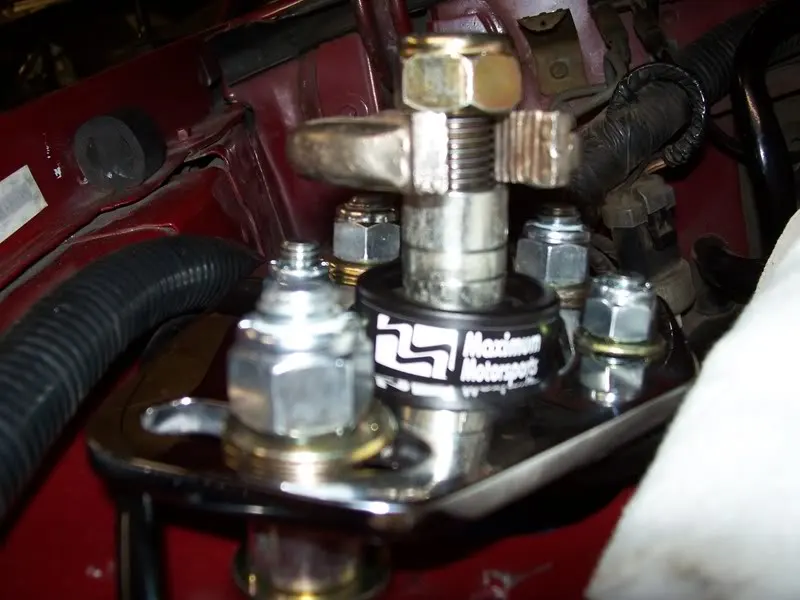

here is a pic with one long spacer on the bottom and 2 short and one long on top
they recommend one short on the bottom and 2 long and one short on top which makes it even longer.....
I wanna get it right the first time so im not tearing the car apart again...
ive put a vise grip in to suck up the excess slack in the shaft to show how far it still sticks up.
the installation instruction on the mm site says as long as you have one spacer above the bearing you’ll be ok, and that you can rearrange the spacers so you don’t have hood issues, so why not move the other spacer below the bearing and that will pull the strut down lower?

Yes i read that as well. I just want to make sure that isnt going to cause me to have tons of extra bump steer or lose travel in the suspension so that it causes issues is all.
