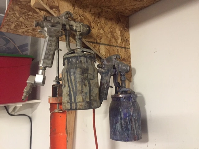

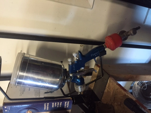

Paint guns, this one is a DeVilbiss HVLP (high volume low pressure) and produces much less overspray than a high pressure siphon type convention gun. Works great so far for me.
These are my DeVilbiss siphon guns, these require high pressure (low cfm) from your compressor but your typical compressor will have a hard time keeping up while spraying a car and these produce a lot of overspray which makes ventilation a key factor or you won't be able to see what your shooting. If you know how to use these and I'm sure @Davedacarpainter does, these can have brilliant results.

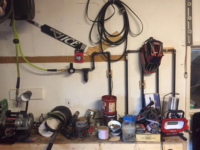

This is my black iron air piping, this helps cool the air and reduces moisture with multiple vertical runs. I have about 35' total, I will be adding another 20' or so soon but so far this is working well for me.

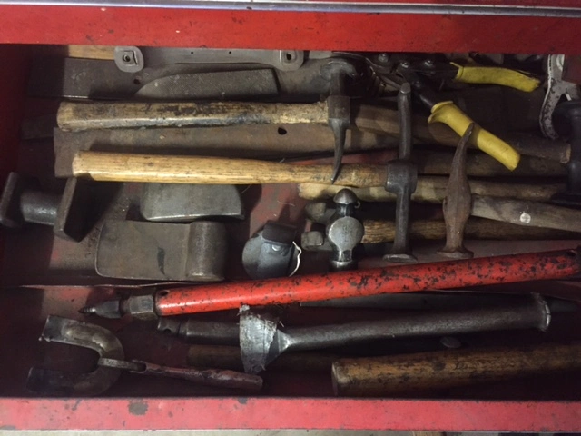

These are good hammers and dollies for evening out metal after pulling most of the dents.

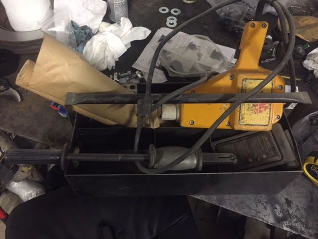

This is my MAC stud welder, studs, & puller. There are less expensive ones out there. This was expensive back in the day! I think my Dad got this back in 98', I forget.
