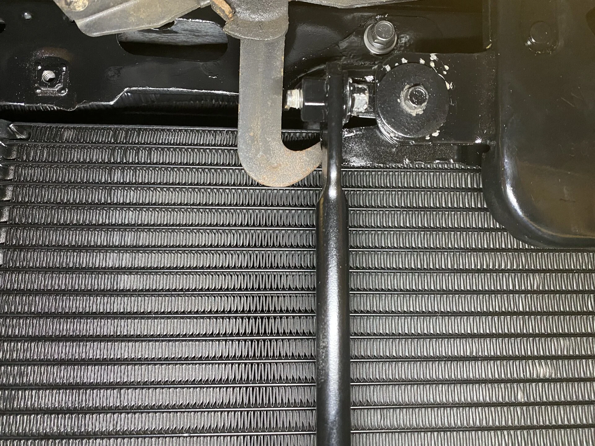

Feb 20, 2022
#40
  • Feb 20, 2022
  • #40
CarMichael Angelo said:
I'll bet it was added support for the hood latch.
Well, couple years later, looks like this is the case.
Assembling my car without front bumper. I was adjusting the hood catch. I did add the support bar, and you can clearly see it’s right where the safety catch is. It’s reinforcing that catch.
Weird how some cars have them and some don’t. But I was able to easily add it to my ‘88. Mounting mounts were existing but I had to supply the speed clips and bolts
