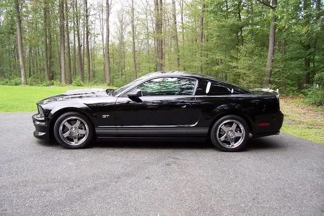

I don't have a pic of my pins themselves but here's a shot of my new hood mocked in with the pins holes cut..

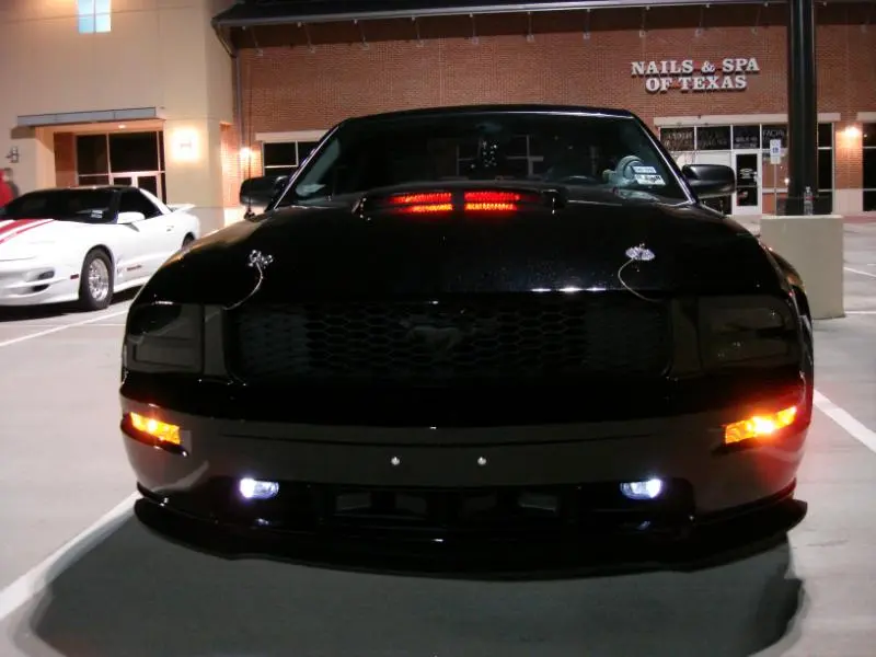

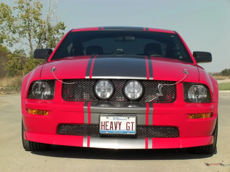

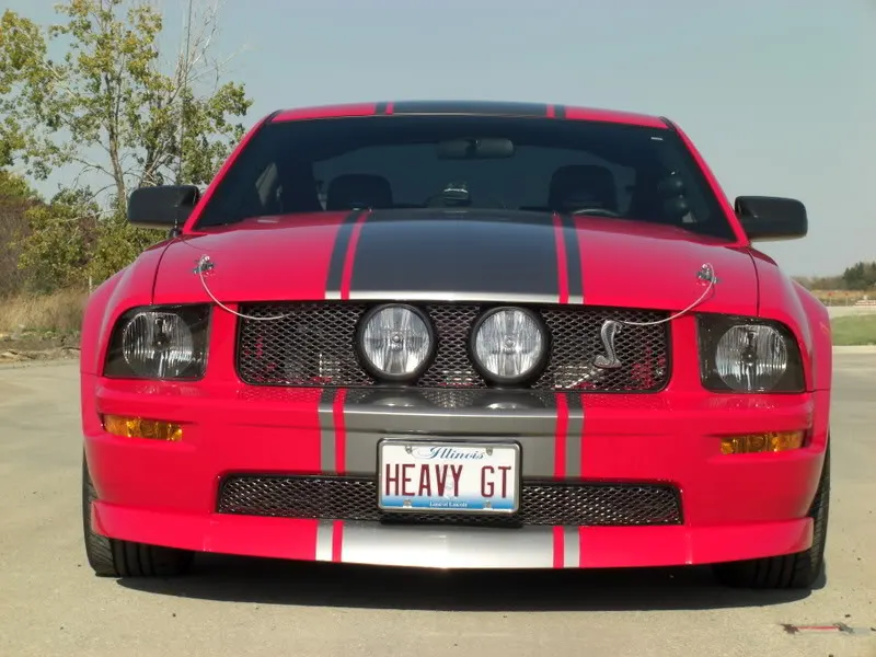

Ahh, not sure your going to find many people with the fakes, I did heavy's pins and I took the cables through the frone speed grill he has, probably within 2 inches of the headlamp pillar.. Maybe he can chime in and post a pic..
For the record his pins are real ones and are in the outer oem bump stop holes.

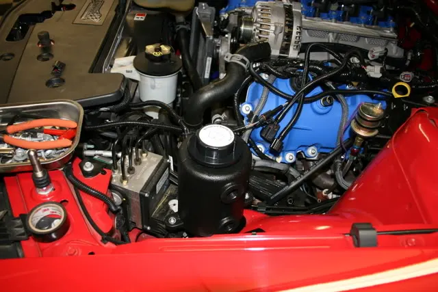

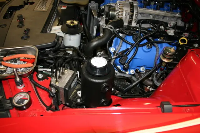

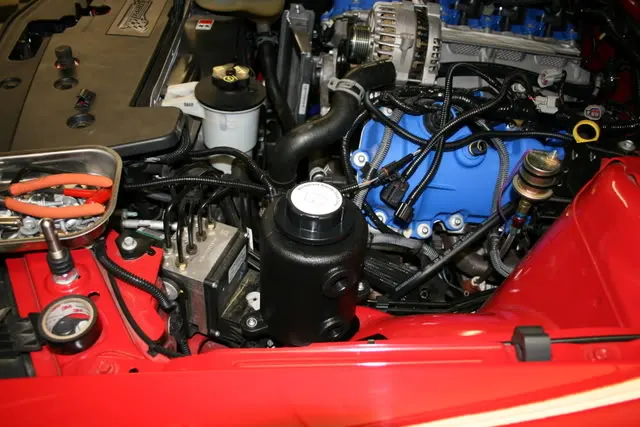

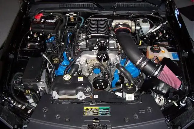

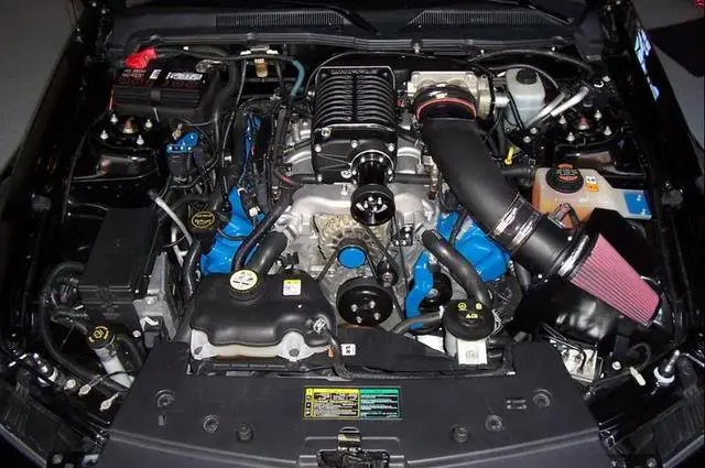

Here is a pic from the SC install...you can see the pin in the lower left...Erin used the outer rubber hood bump stop. If it was up to me, I would return the fake ones and get real hood pins.

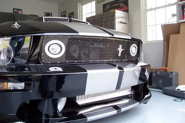

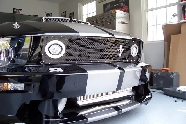

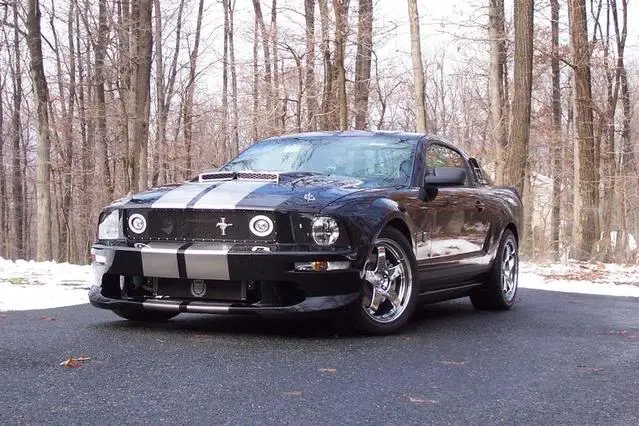

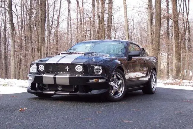

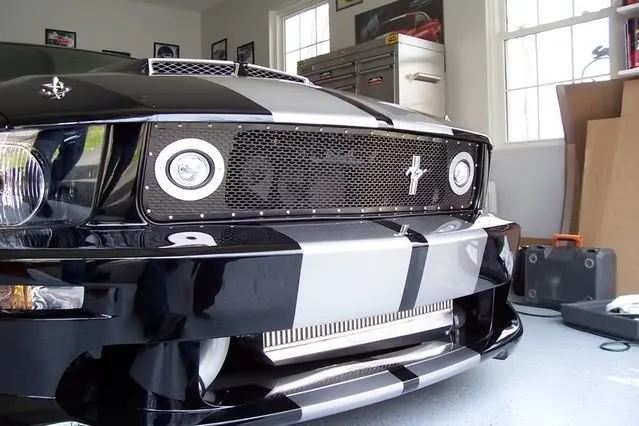

I don't want to hijack the thread, but thanks, here's a few other pics. That CS-6grille has lights that are kind of small. That's why I fabbed up the trim rings.
