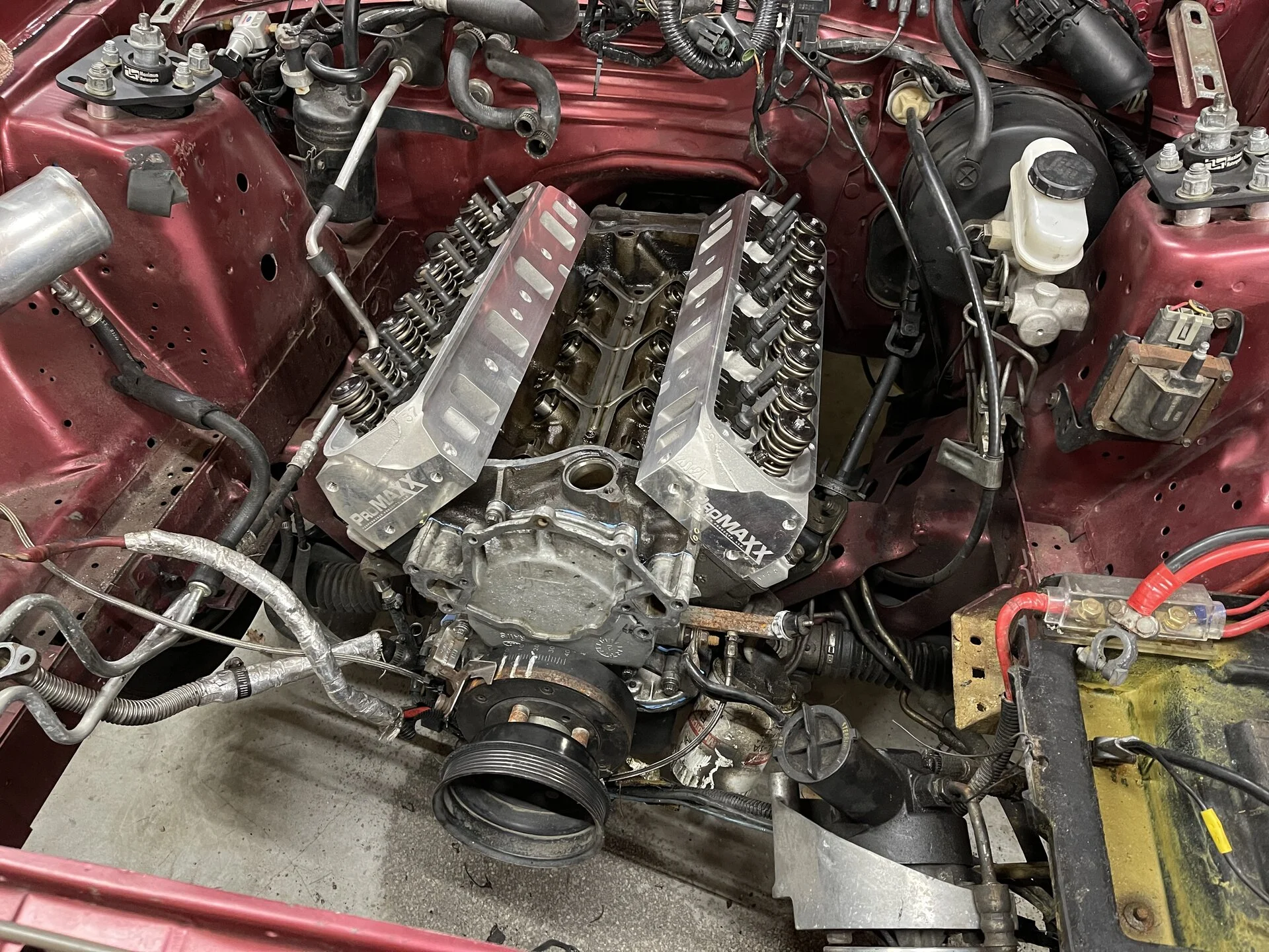

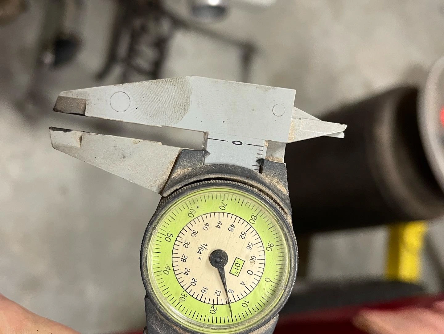

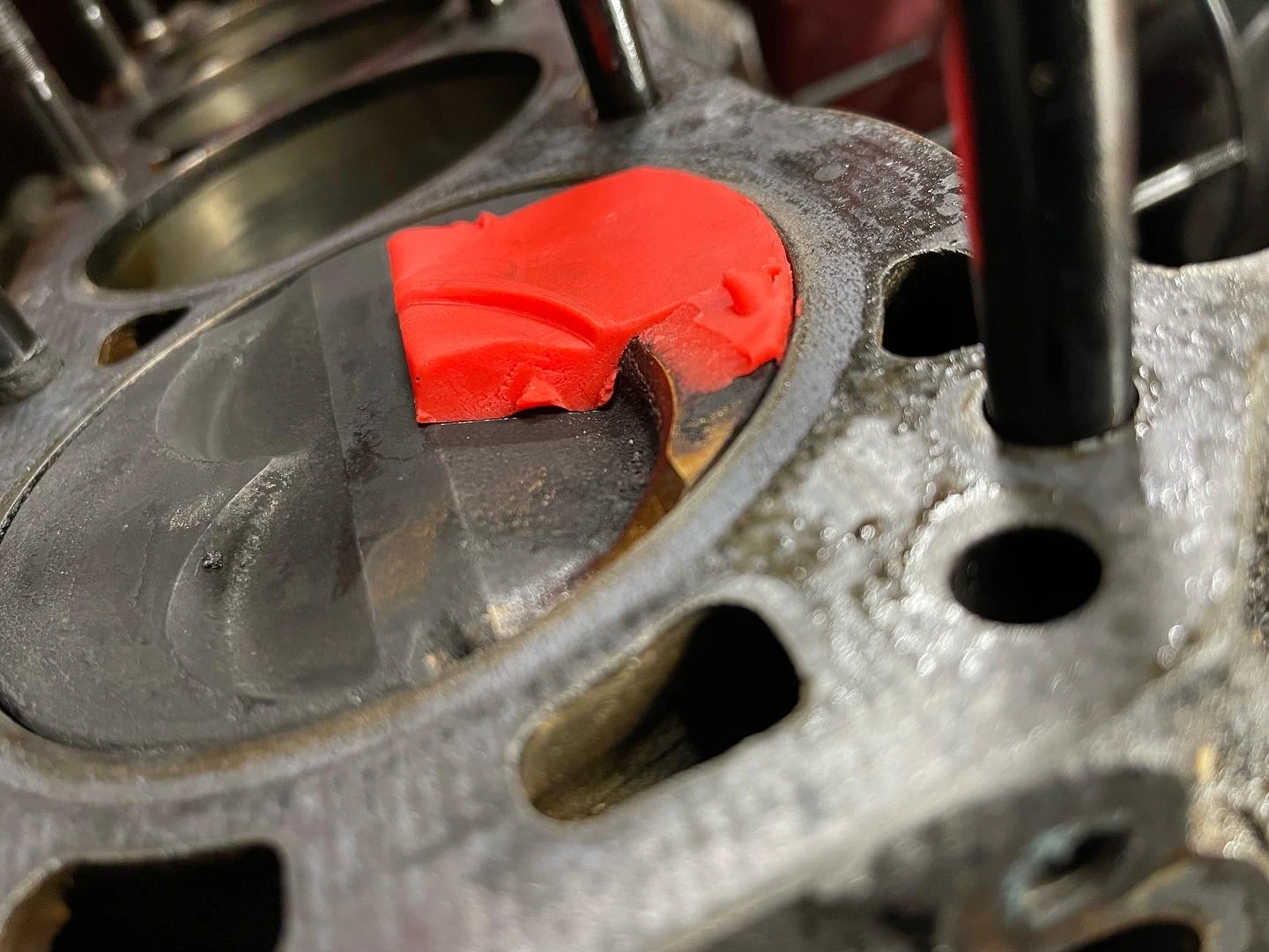

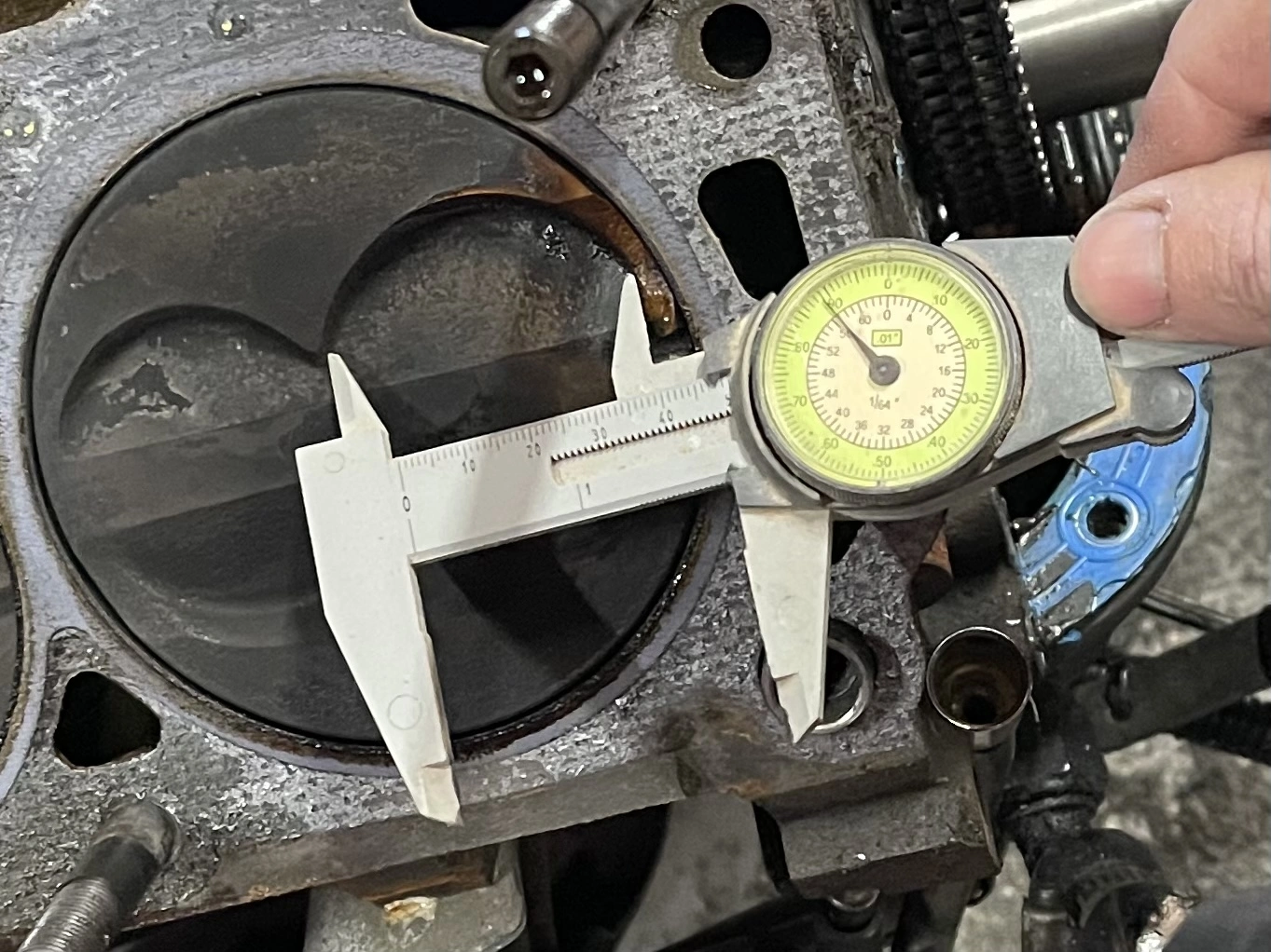

I’m hoping to have time to go out there in the next couple days and keep chipping away. Obviously these aren’t stock pistons, but they’re only 1.90 openings. I also noticed the block has been decked and the piston doesn’t sit in the hole. From what I can guess, the reliefs are about 10cc based on what I think is info on them I found online. With the .027” HG, I should be at 9.2:1 compression.
