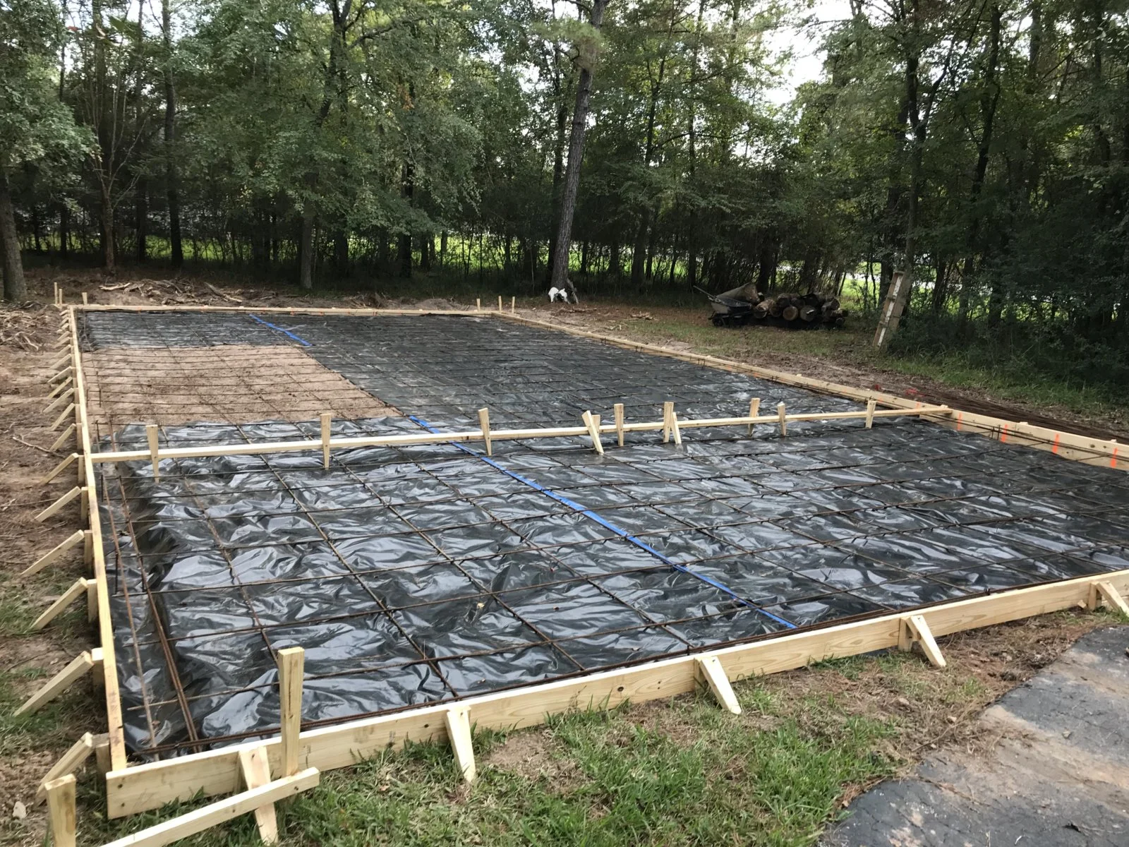

OMG OMG OMG OMGGGGGGGGGEEEEEEEEEEW

But.... why did you put rebar on the slip and slide????
makes no sense people are
gonna get hurt...........

Looks good! You're using rebar so I'm guessing you're planning on using non fiberglass reinforced concrete. That's great. If you are planning on putting down a floor coating do not use the fiberglass stuff. I told my crew not to use the stuff but they did it anyway. Made for a lot of extra work and headache to get the floor prepared for the epoxy. I could have strangled every one of them!

Good point! But no, just 3500 psi mud.

Mine had the fiber reinforcement, no hair, don't know what was up with yours.

I think they put extra fiber in it or something lol.

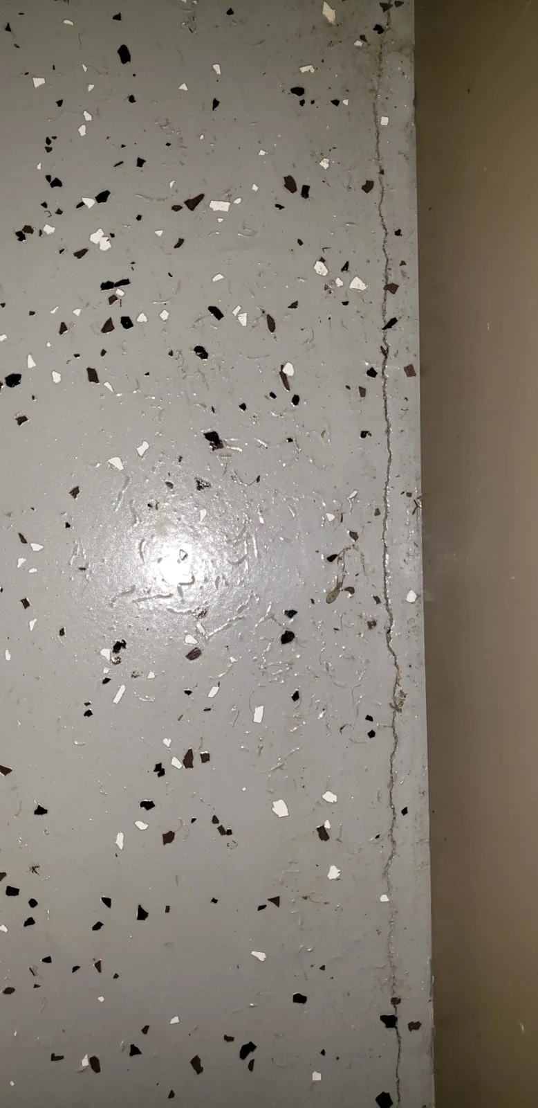

What's with the crack?

Thats a good question. It cracked like that all the way down the wall. I'll be keeping an eye on it. If it get worse I'll have to get my builder involved. I dont think they put rebar in it. That is the floor in the garage. The pad was already down before we even knew about the house so I didn't see it go in.

I would contact the builder now.
mine is a monolithic pad, it has a footer with rebar, my builder says if you don't bevel the dirt where the pad and the footer intersect then it can crack.
