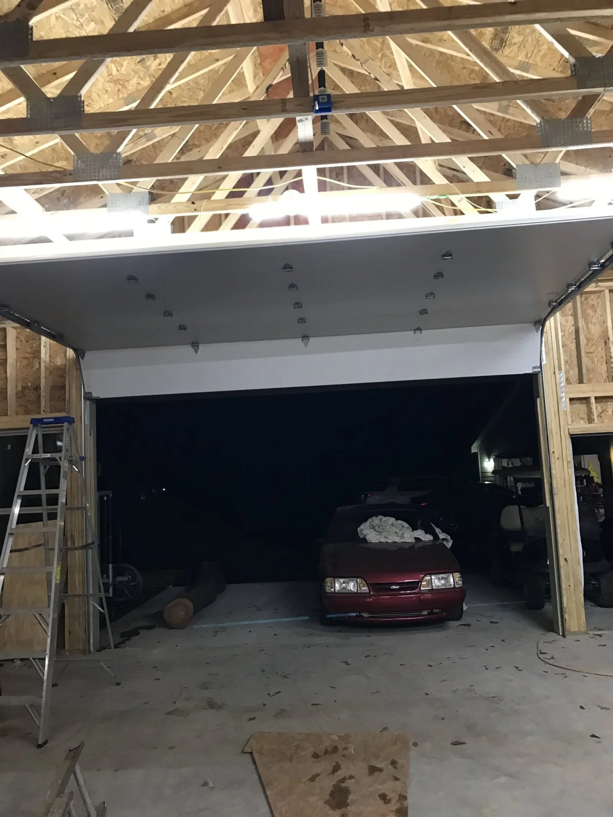

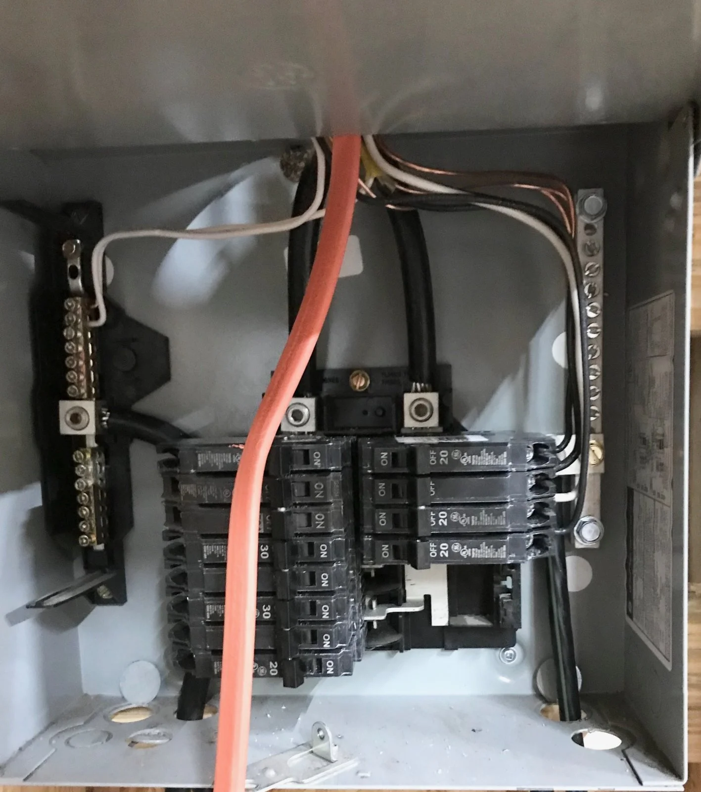

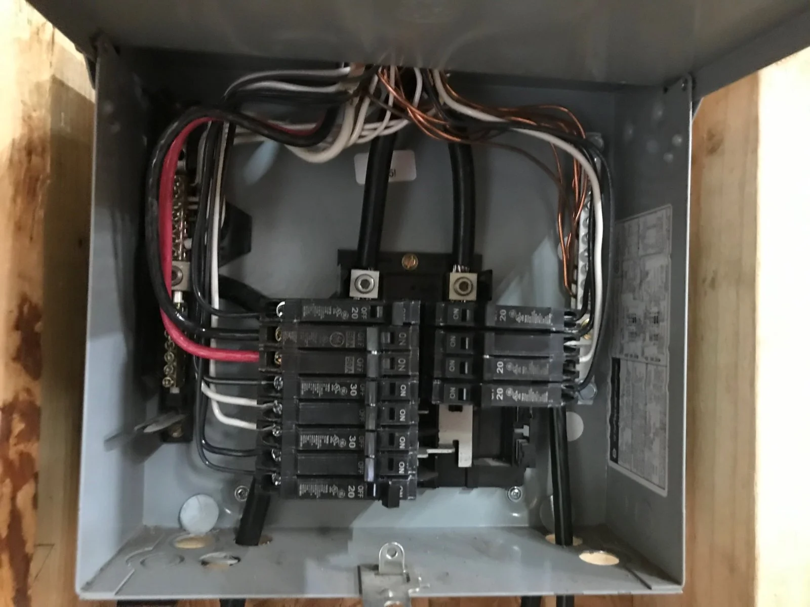

Progress! I picked up 165' of 1-1-1-3 aluminum SER cable yesterday and stubbed it into the shop and up into the panel. Although aluminum, it's still heavy and unwilling to bend, so it took some manhandling - especially those last few bends into the box as pictured. I got 3 circuits wired in and quit at the lift 220 (the orange dong hanging front center). But it was going pretty quickly and easily at that point.
Next is renting a walk behind trencher for a saturday morning to make the 150' run to the main panel. Once tied in, the shop will be hot and that should be that. I double checked this morning and being out in the county - there are NOOOOO inspections or permits required (except septic) so it's good to go.
I'm also getting about 10 bags of insulation for free, but that's for the wood shop. I'll do the car area later on.
Finally, the garage door guy is coming this evening to try and figure out what the malfunction is there. I hope he goes easy on the bill because this was the last push and I'm spent for a while!!!

Before you light that up.. dont kill the terminations but.. wiggle tighten wiggle tighten ect. until the lug has no more give aluminum has a bit more give than copper. you dont want to over tighten the lug but it needs to be seated correctly before you call it done
Good to know. I'll certainly do that. I couldn't live with myself if I burn this bish down, after all the work I've put into it.

I had the springs reversed. Once that got fixed the door worked like a professional had installed it, LOL

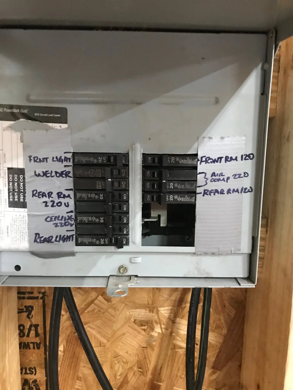

More work on the shop! Got permanent power finally, so we're one step closer to... something. Not even sure what the end game is anymore, BUT! everything works. Here's some pics.
The "ceiling 220v" is for a lift. *rubs hands diabolically*
