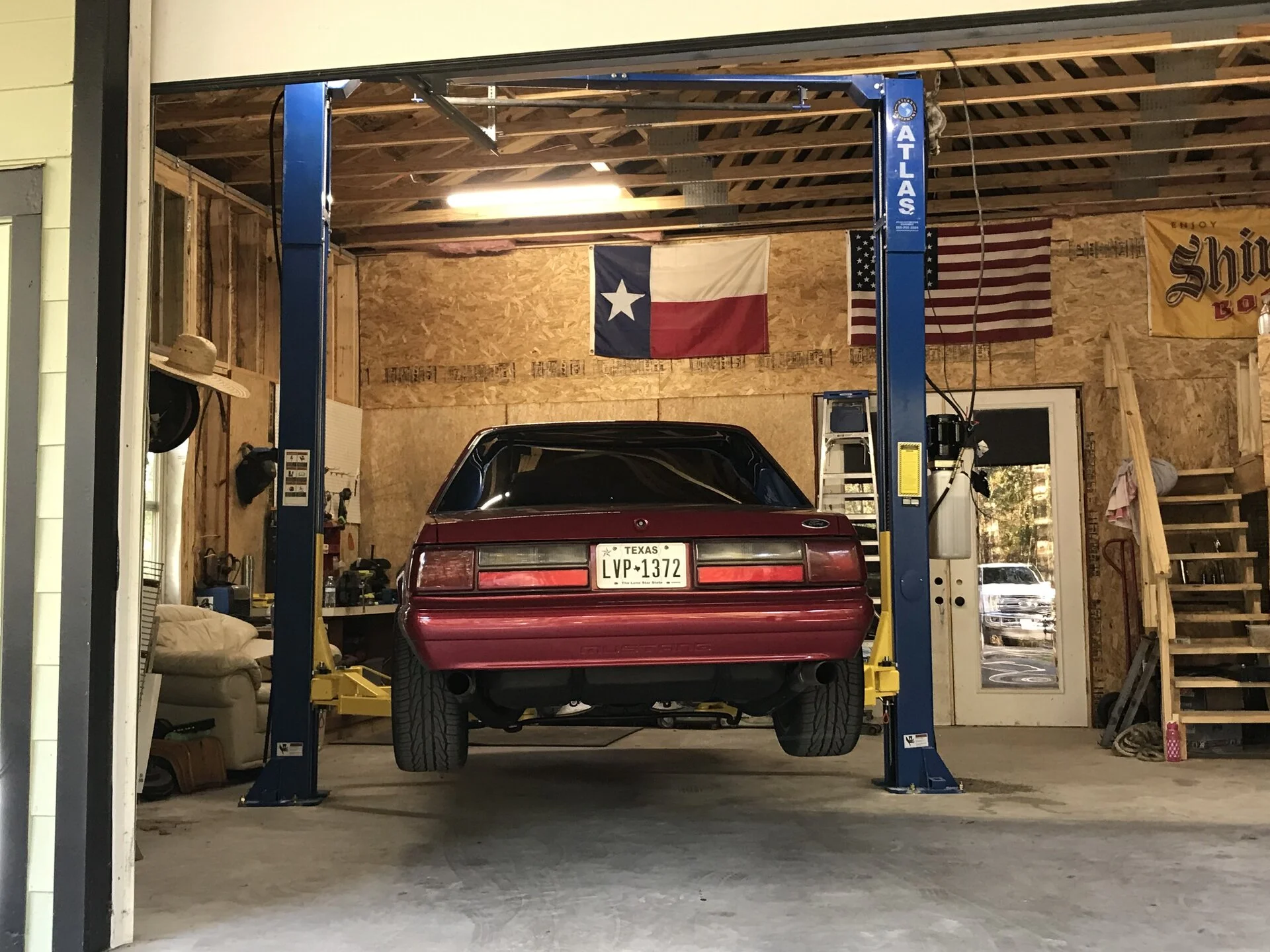

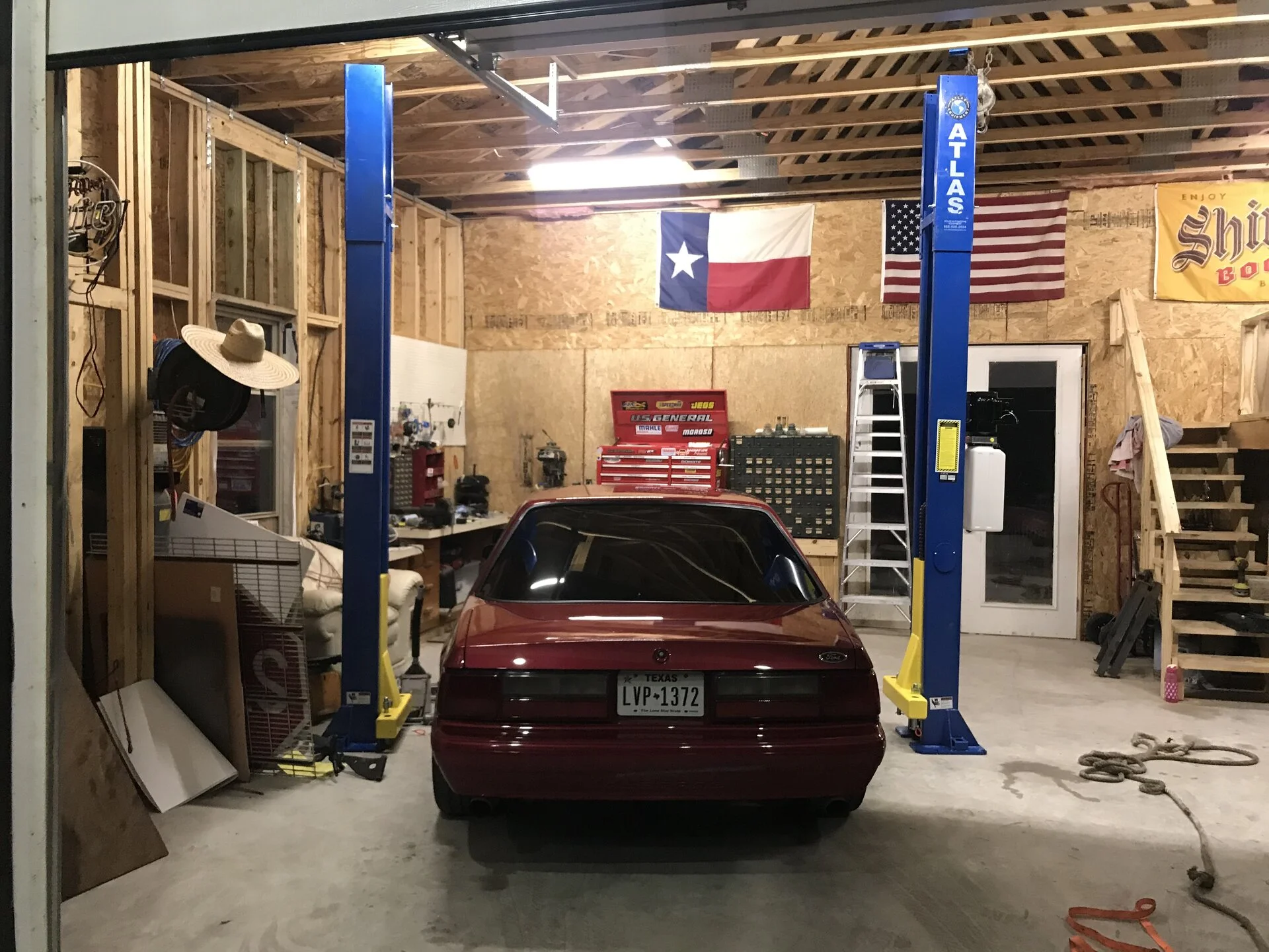

Got the posts stood up, hydraulic unit bolted on. Stuck until I can get the anchors in. The car won’t be staying there tonight for that reason, lol

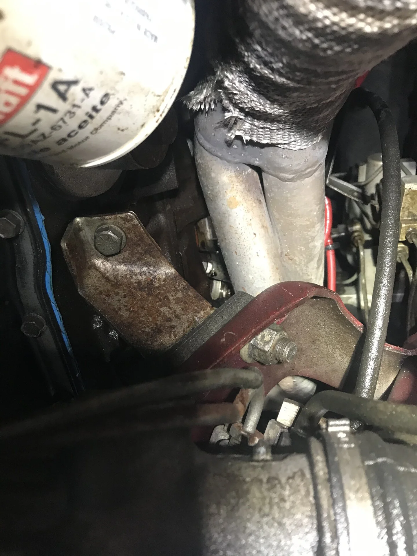

Hard to see, but I’m having oil issues. When I get in boost, oil pours into the car and behind me looks like a smoke screen. Upon inspection today, the entire driver side of the engine bay is COVERED in oil. I think the crank case is pressurizing and oil is shooting out where the dipstick goes into the block. I need to install my vented valve covers - still no venting on the motor. Whoops

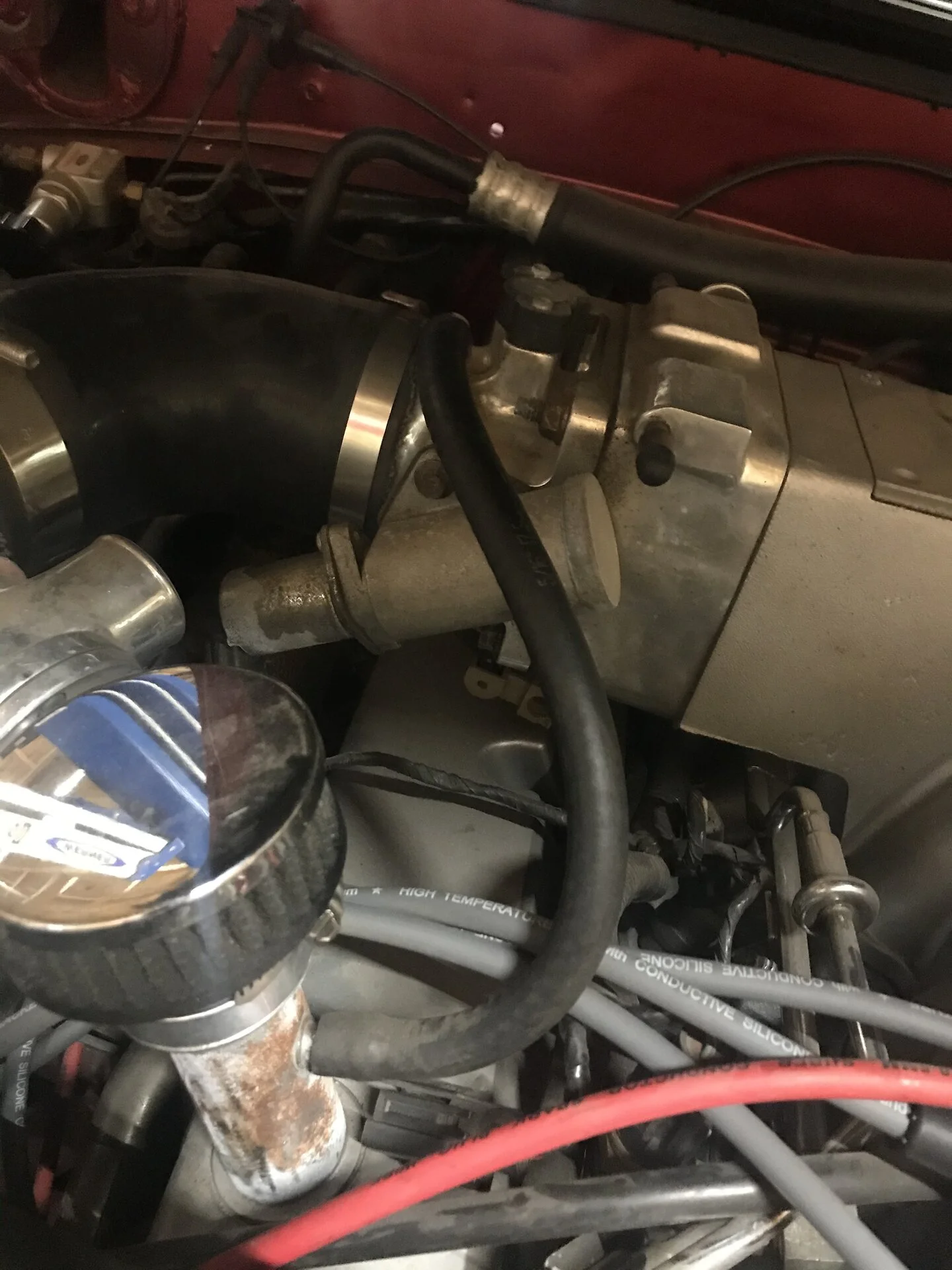

“Wonder why my crank case is pressurizing?”
“Wonder why my boost is lazy”
“Wonder why....”
Ive always seen this hose and thought it wasn’t right but after seeing all the oil puke, i get it. Derp.

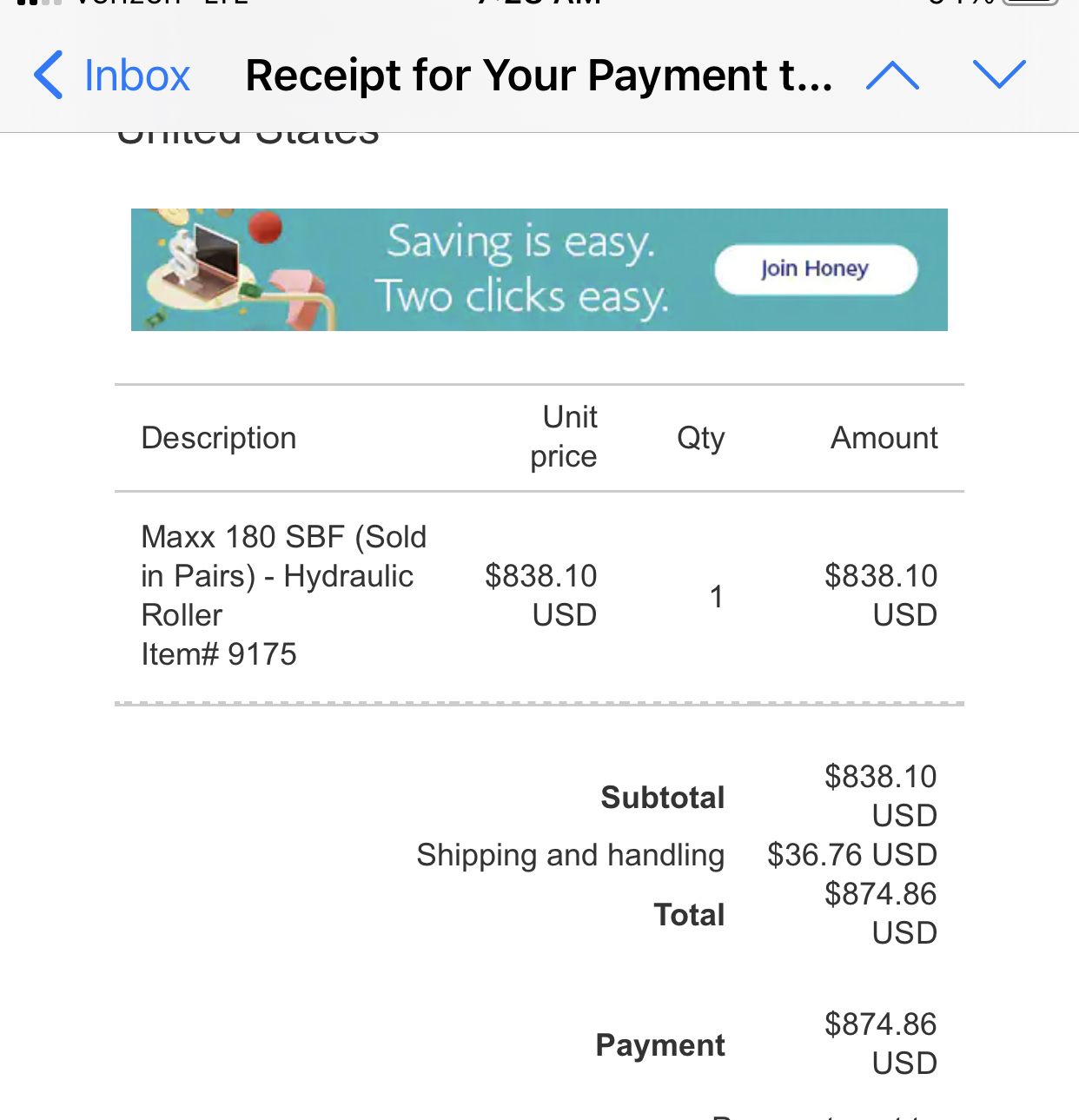

So I sold some parts today and have money for a catch can and all associated parts. Will get a new radiator as well. That should cure the drips and sprays I’ve been dealing with.
After reading a thread on face place, it sounds like my E7 heads are lifting, even at my measly 7 psi. The coolant system is pressuring and filling up the puke tank and the coolant smells like exhaust.
I want to upgrade to something that’s going to be stronger but not so much of an upgrade that I have to start replacing supporting parts. So, a 180cc runner head or less.
